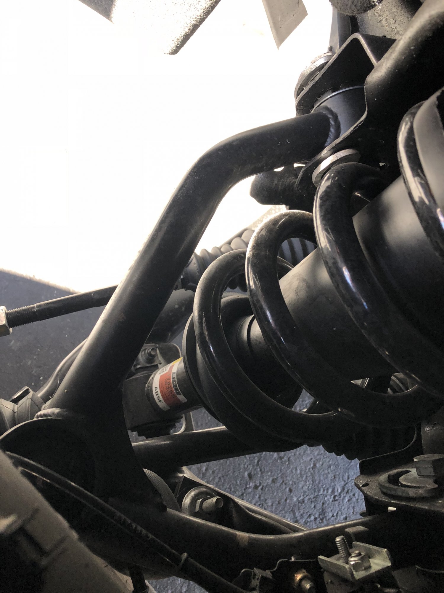

what size tires are you running stock? stock wheels with +27? offset? no rubbing? I have the Readylift UCA with the stock tires, 285/45-22 and stock +24 offset wheels,  the tires barely rubbed at full lock. I welded a steering stop to the LCA on both sides, then had about 1/4" clearance at full lock.
I then installed new wheels and tires, 18x9 +18 offset with a 285/65-18. By calculation, I should have had an additional 1/4" clearance, but the new tires actually rub WORSE.  The tires are obviously wider than the factory 285.
I am very curious if the Cognito arms will give me more clearance. Looking at the geometry between the 2 arms, they look like they have a straighter front arm angle and would allow for more clearance.
Can you please post up pics of the front of the arms with the wheels turned to full lock?
Thanks

Yea I was running stock 18s with 265/65 tires no rubbing issues. I just went to a 20x10 -24 with 33x12.5 tires and no rubbing issues either with this new setup.

by the looks of the cognito, it appears my rubbing issue will be resolved. i am going to buy them
i will sell my Readylift arms cheap (1/2 off new). they have about 2500 miles on them

thanks for the pic.
the leading arm is much straighter to the ball joint than the Readylift. I think my rubbing issue will be resolved with those
