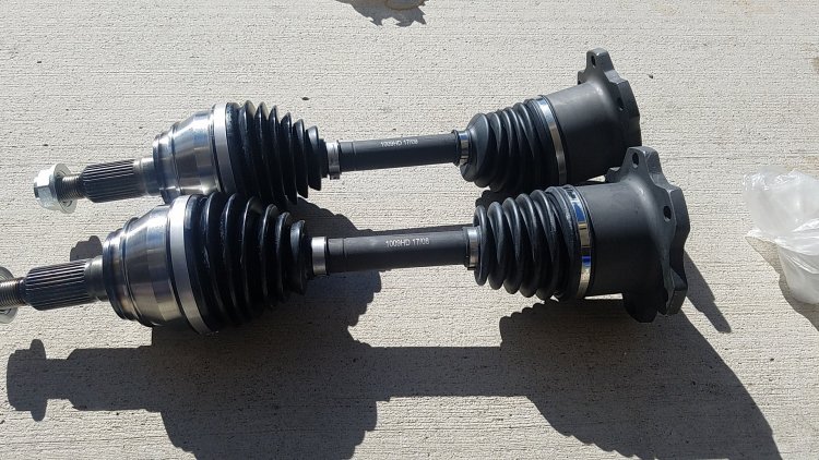

Since I was already working on the front end, I replaced both axles seals as they leaked, replaced CV axles as one had a torn boot and grease was getting flung everywhere and also the hubs even though they seemed to be good.  The seals were ACDelco 22761722 and they came out easliy using a slide hammer  (rented from AutoZone).  I purchased two brands of CV axles (NAPA MaxDrive and A1Cardone) both were new and the heavy duty version and were borh the exact same meaning NAPA is rebranded A1Cardone. I called Cardone to inquire difference between regular & HD versions a the only difference is the HD a thermoplastic outer boots and thicker bands; thats it but worth it due to a small cost difference
20180309_094306.thumb.jpg.c76020c514878cb67614c568ceb11d13.jpg 20180309_094139.thumb.jpg.bd7556e860f2bfb1cc365b2fdb6a5bdd.jpgTop shaft is out of NAPA box and Cardone the bottom.

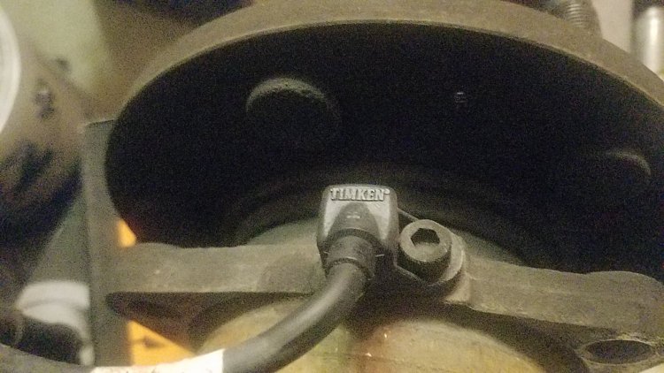

As for the bearing hubs assemblies, I ended up going with Timken as they are Made in USA and are known for highly dependable and quality bearings. To my surprise as I remove the stock hubs, the OEM were Timken brand as seen on the wheel sensor and look identical to the new ones.  Question: are your hub assemblies Timken as well?  My '07 GMC 1500 Classic was made in Canada and I'm wondering if that matter compared to GM made in US ir Mexico.20180328_202606.thumb.jpg.64fa7db996adbdb24c3ded2e12bbd40b.jpg
