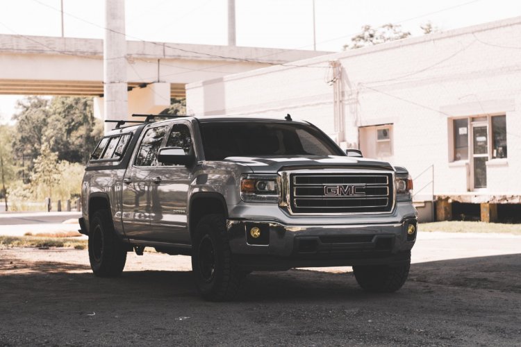

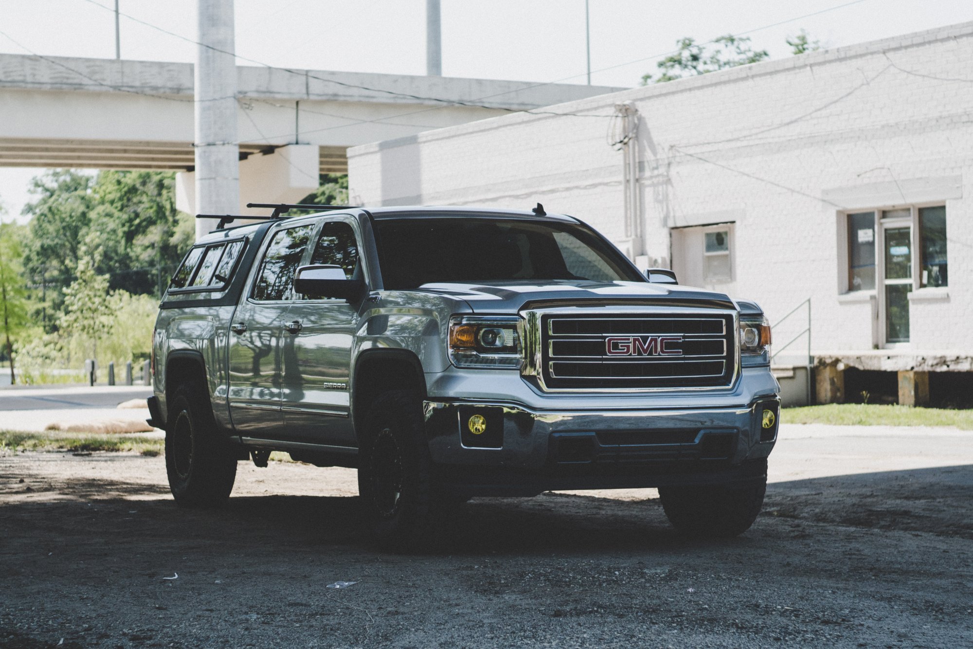

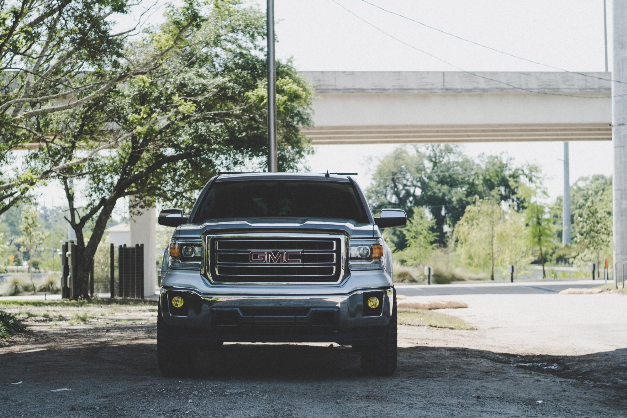

So, I have had this truck for about 3 years and I have finally started doing some modifications to it. I pretty much just stayed on social media too long and followed a whole bunch of outdoors members because I'm interested in that sort of thing. I eventually fell into the hole of overlanding. This is my "overland" sierra. I'll post the mods so far and whenever something else comes up I will try and update. Hopefully I'm posting this correctly, I have used the forums before but not as a member, I apologize if I'm going about this wrong.
To start:
-ARE Oveland series topper with outdoorsman side windows. I really enjoy the topper, there are some spots where it could be a little nicer but overall I love it, keeps things dry and locked up.
- Method Race Wheels. NV 17×8.5. 0 offset
- Cooper ST Maxx 285/75/17. These tires are awesome, they are like a mix between an all terrain and a mud tire. The tired are still quiet on the road too. This set up is run with a leveling kit of some kind (previous owner install) the tires rubbed pretty hard in the inner wheel well, trim a good bit of liner, the plastic trim and hammer the wheel well back a little and you're in business.
More mods to come as soon as my bank account stops crying.
Thanks guys
