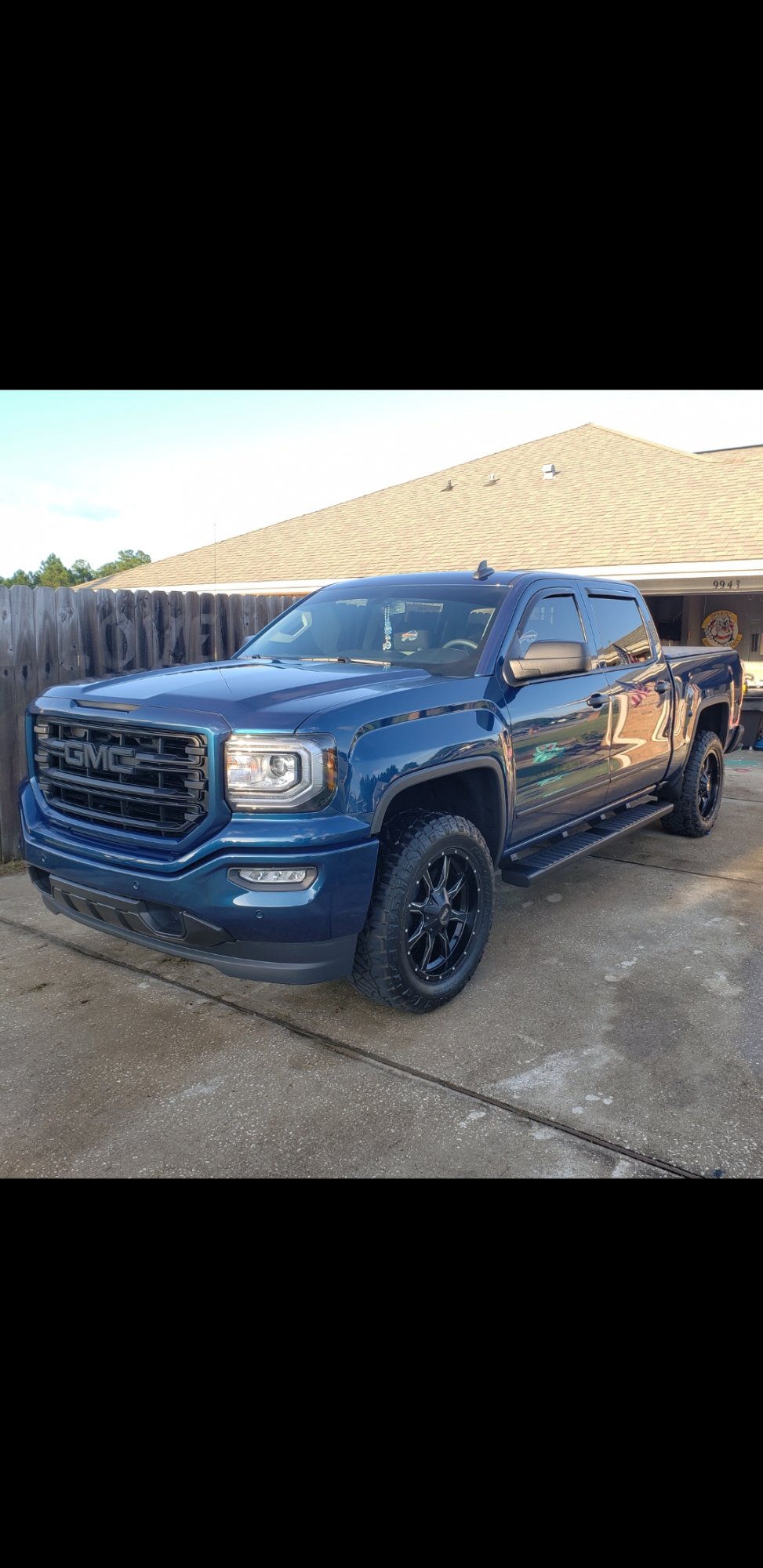

On 8/28/2018 at 10:02 AM, mrskiff said:
You wont regret debadging and color matching. I have a silverado the same blue and it looks awesome color matched.db7de244ecf2f6084b83b255b4793c4f.jpg
Sent from my SM-G950W using Tapatalk
This seriously looks so good!  I just got a new 2018 and I want to do something like this on my truck but all the paint shops that I have reached out to have told me that they refuse to paint over the chrome, even with roughing it up first.
I just think that the front and back bumper are too much chrome...
Try Maaco my local shop even said they'll guarantee it locally.

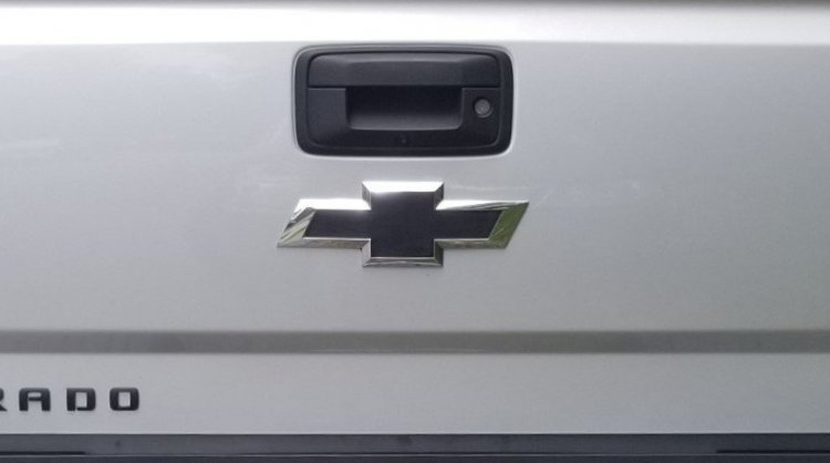

8 hours ago, Jeepin9910 said:
Where did you get those bowties?
You can buy vinyl for like $6 at Amazon or EBay, if you don't need a different contrasting color. I left mine chrome, but could have just as easily painted the plastic. I removed both the front and rear emblems, drilled out the plastic fasteners, wrapped the bowtie emblems and 3M taped them back in.....
Where did you get the black lettering, please?
It's plastidip. Tons of YouTube vids. Took me a couple of hours. 5 light coats, 10 minutes apart. 2 coats clear.
If you don’t want to do the Plasti dip they are available on eBay type black Silverado letters in the search on the auto parts page. Silverado, Chevrolet, LTZ, LT, 2500HD, High Country, Transformers, Decepticon, Captain America, Bumblebee and Cheyenne all available in black. Also Silverado, Chevrolet and LT available in redline.
Thanks, because I really don’t want  to have to buy emblems then plasti dip them.
Please don't post pictures like this, it's too late for me to go try to debadge to mimic the look. Very nice! ;)
