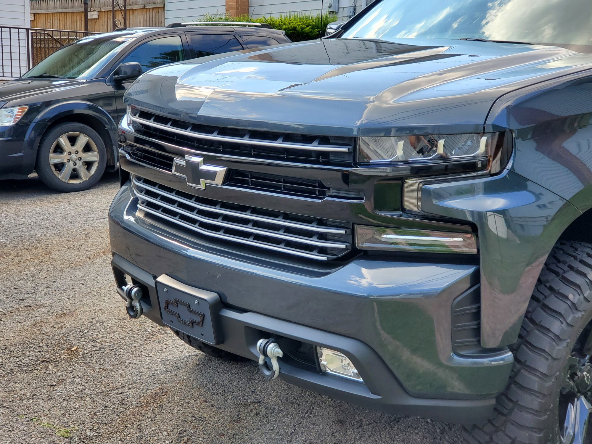

Air deflector removal and trail boss recovery hooks. I also cut and sanded the tabs where the bolts went, looks factory.

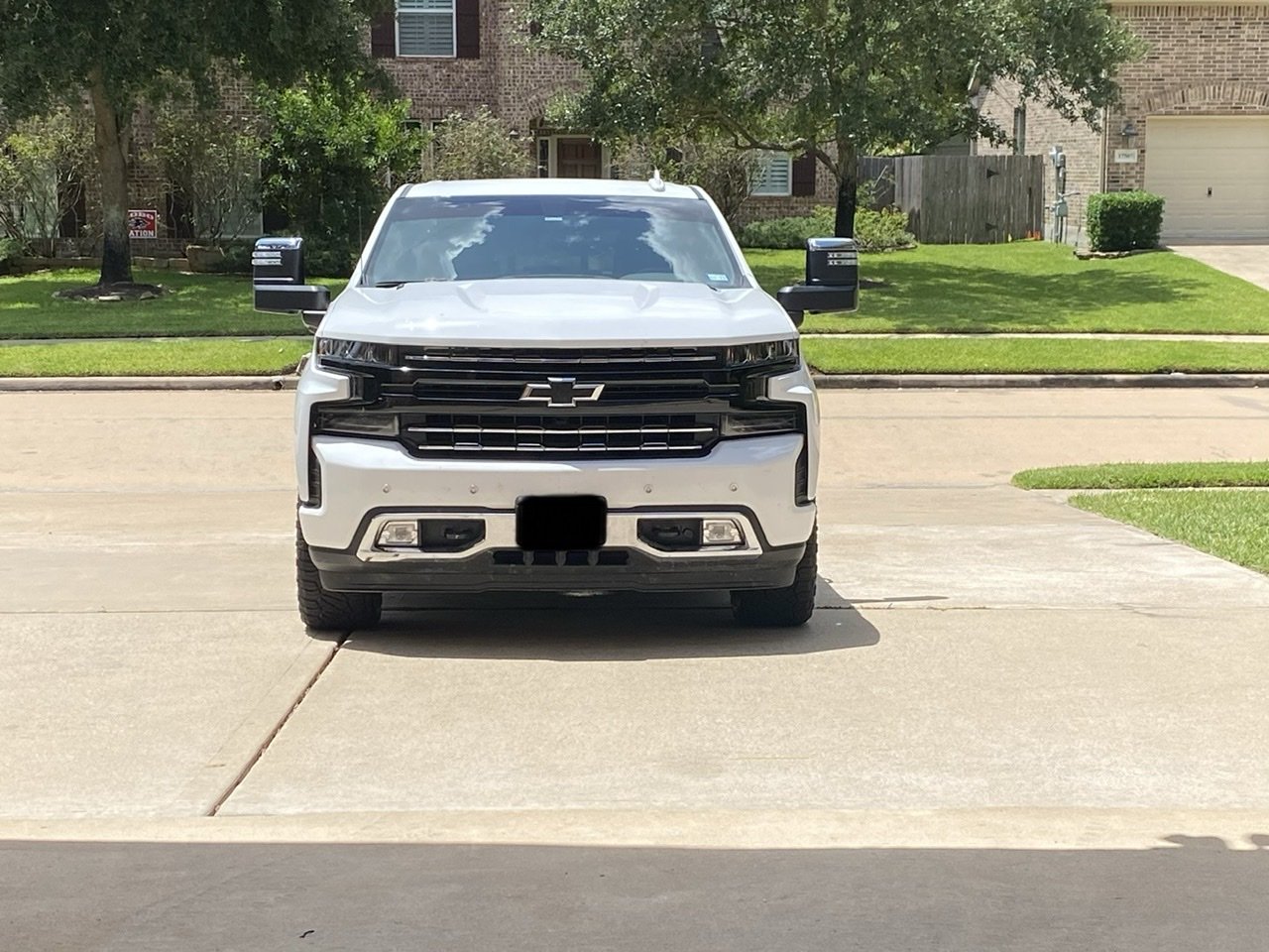

Installed factory power folding tow mirrors onto my LTZ that came with power folding safety mirrors (no camera).  So far the blind spot, power adjustment, and power folding work like factory.  When I press the task light it turns on the mirrors parking lights, and at night task lights will come on pike the puddle lamps did previously.
I still need to order the door harness’ and see what lights will work after.

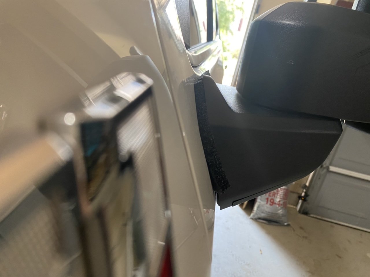

Couple of things to note, GMC mirrors are different than Chevrolet ones, that learned this because I bought 1 of each off eBay.  I was able to make it work, but the body lines are different.  Also mirrors from a HD truck will not work either, the wiring is too different, and our half ton trucks do not have the correct circuits.
Here’s a pic of how the mirror doesn’t line up, that piece of foam was just in there for test purposes.  I will be buying a silverado driver side when I find one.  This is the driver side GMC mirror part number.

Got any pics where you did the sanding? I took my deflector off a while back but still have the tabs in place. Haven’t decided how I wanna handle it...
I’ll post them tonight when I get home
Cut and sanded the tabs with the exception of the two tabs that support the plastic part of the bottom of the bumper. I did however paint the bolts black they were gray so now they don’t stick out like a sore thumb. The corners where it basically meets up with wheel well insert I just cut and sanded it to flow while leaving the eye hole there.
