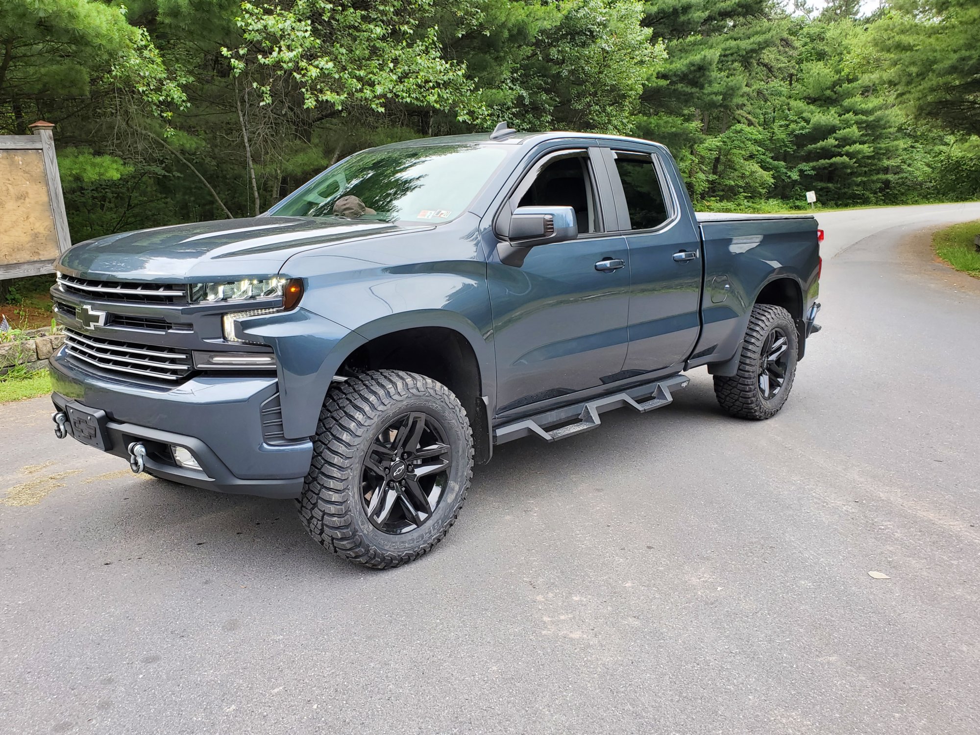

On 7/13/2020 at 5:21 AM, Flatblack83 said:
35 12.50 20 bfg km3s, removed the mud flap brackets, pulled the liner back with a zip tie and no rub.   Also tinted corner lights and mirror lights.
Any other mod for this set up? Spacers, level. No type of rub at all? Thanks, looks great.
Up front, Icon coilovers set to 3 inch, rough country uca's. Removed the mud flap brackets and pulled the liner back.  On the rear just 1.5 blocks and bilsteins.  Now these are trailboss replica wheels with a +15 offset. So that helps keep the tire off the uca's.
How's the ride quality with he ICON coilers? I am looking at ordering their kit, but can't seem to find much info on the GM/Chevy  installs. I found a video of a guy putting them on his ram, road bumps and trains tracks appeared to be absorbed by coilers. I don't do much off roading with my AT4, so the I won't be getting the reservoirs.
They are firmer than the rest, fox or king will ride smoother. Its firm but handles real well. I don't have the reservoirs either, mines just the stage 1.  The less preload the smoother tho, thats why mines at 3 inch and not 3.5.
Installation is pretty easy, not much too it. Make sure u do some sort of control arms tho.
