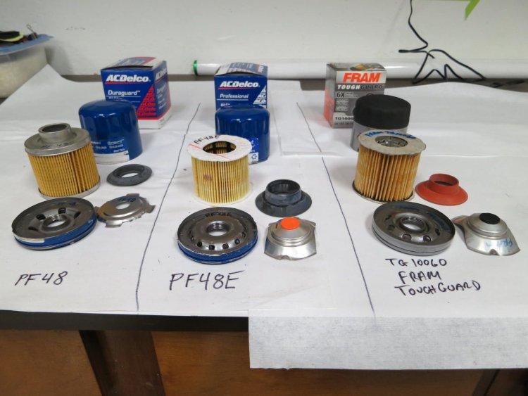

Here are two filters that I have cut open:
Fram Ultra XG10575: https://www.bobistheoilguy.com/forums/ubbthreads.php/topics/3534172/Cut_open:_Used_Fram_Ultra_XG10
Mobil 1 M212-A: https://bobistheoilguy.com/forums/ubbthreads.php/topics/4580584/Cut_open:_Mobil_1_M212-A_used_
I thought both were constructed well but I like the media in the Fram Ultra better (more robust). As some of you may now, GM changed their bypass specs for the Gen5 motors (now 22PSI). From what I have gathered the Mobil filter meets these specs but the Fram does not (9-15 PSI). I read that Fram will be releasing an updated filter with higher bypass at some point.
