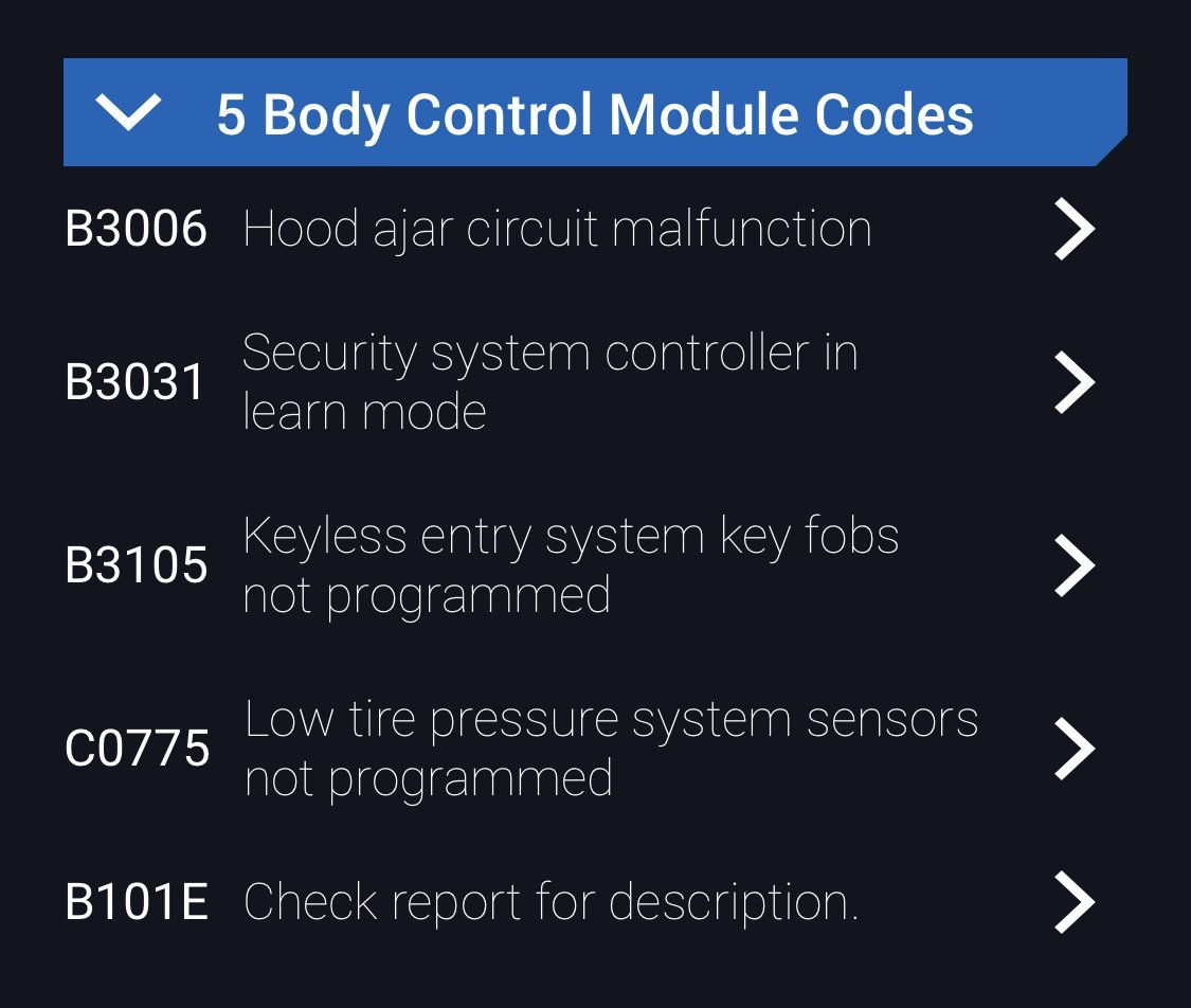

Been having the same issue from purchase Found some BCM codes and cleared them. Range for key fob increased a lot. No more message saying key fob not found. One code was B3105 - deals with key fobs. Hmmmm. Codes have not returned.

What did you use to scan? I had a generic obd reader with the obd scan software from App Store and it wouldn’t read these codes. Only bluedriver did. I don’t know about the other wire ones. Just something to keep in mind.

As stated above I used blue driver. I know some have mentioned that gm has a bulletin out in using blue driver because it over loads the canbus module but I was experiencing the same issue. I had the blue driver do a deep scan and it pulled several body codes and one u code I believe. I cleared them all and my remote works fantastic based on my experience. I lived with the short key fob distance for several months and just kinda stumbled upon it.

Yes it’s the blue driver from amazon. I had a generic one and used the OBD app and it did not pick up these codes. I had no lights on.
Yes once I cleared those codes my remote works like 200 ft away and from my office through the window I can start the car. Before I could not which made me pissed because my Kia would start from the same spot.

What I don’t get is why the dealer don’t acknowledge these codes and clear them. They have the correct tools that are designed for these vehicles and I can find it with a $99 tool, clear them and my problem is solved. Crazy
