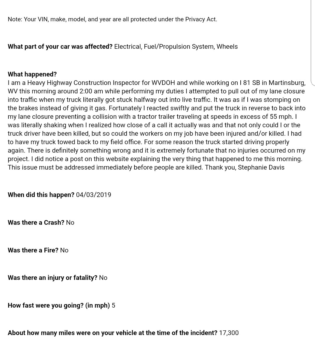

The same thing happened to me last night. This is the report I sent to NHTSA. What did they have to do to fix the issue? My dealer came and picked up my truck and dropped off a loaner but I have no idea how long it will take to fix.
