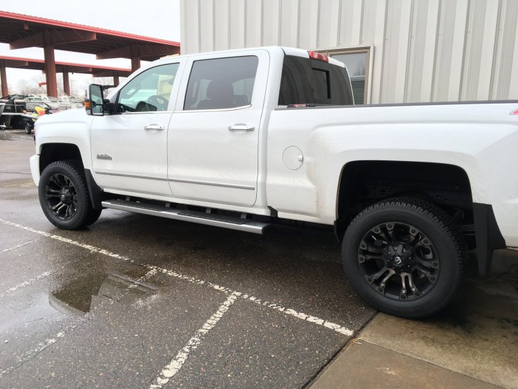

The 295 60 is probably a better gamble..That said, if you shim the bumper out a half inch that might be enough for the 305’s.  The tire dealer might test fit a couple sizes for you.  The 295 60 will be roughly 3/4 inch taller and roughly 1/2 inch narrower.  You are more limited to tire brand options in the 295 60 size though I added a pic of mine when it had the 285 55’s with 0 offset fuels.  Too small imo.

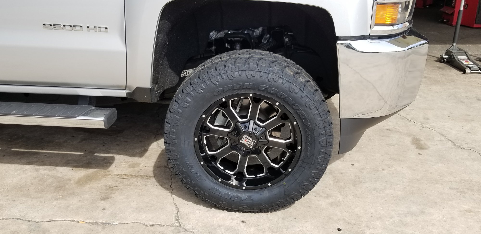

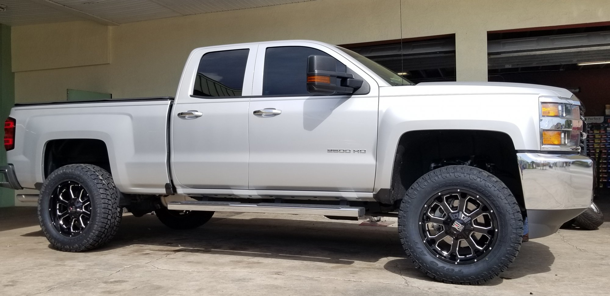

We mounted the 305/55 and it was to small
The 33" tire looked lost with the truck leveled
Thank you all for your help !

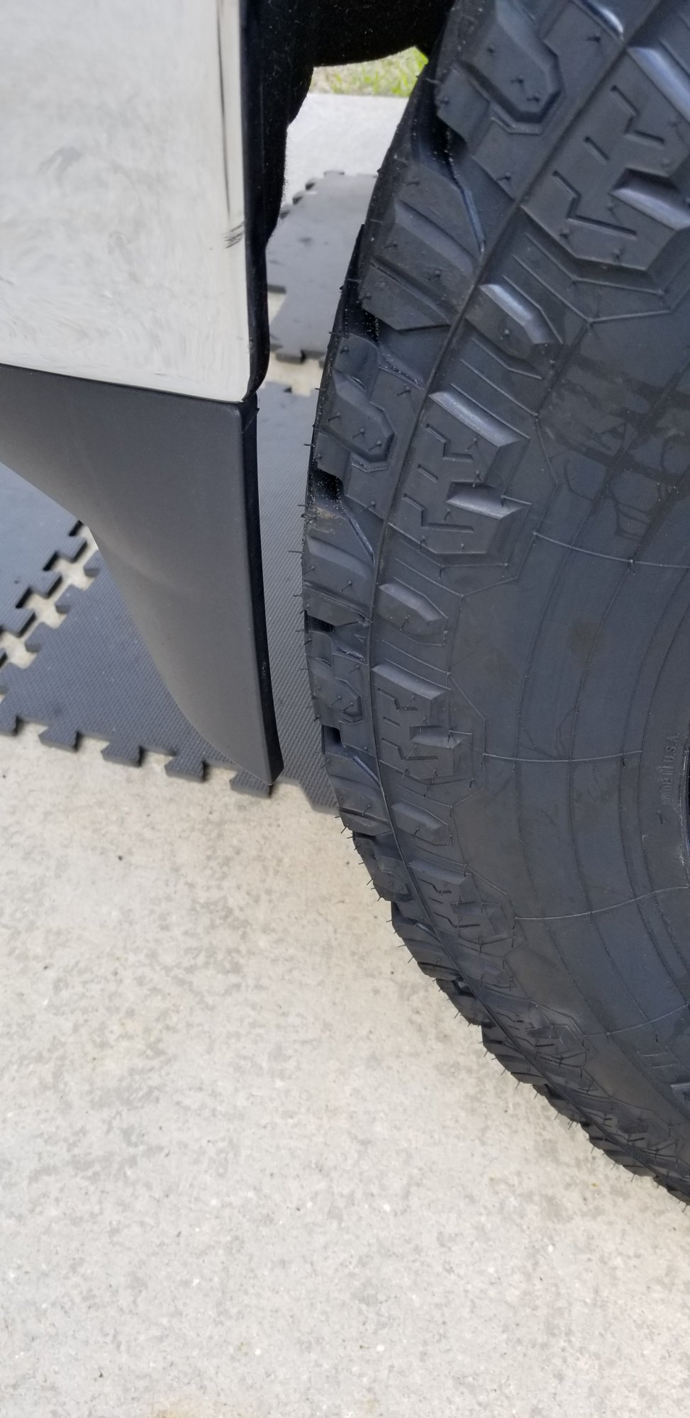

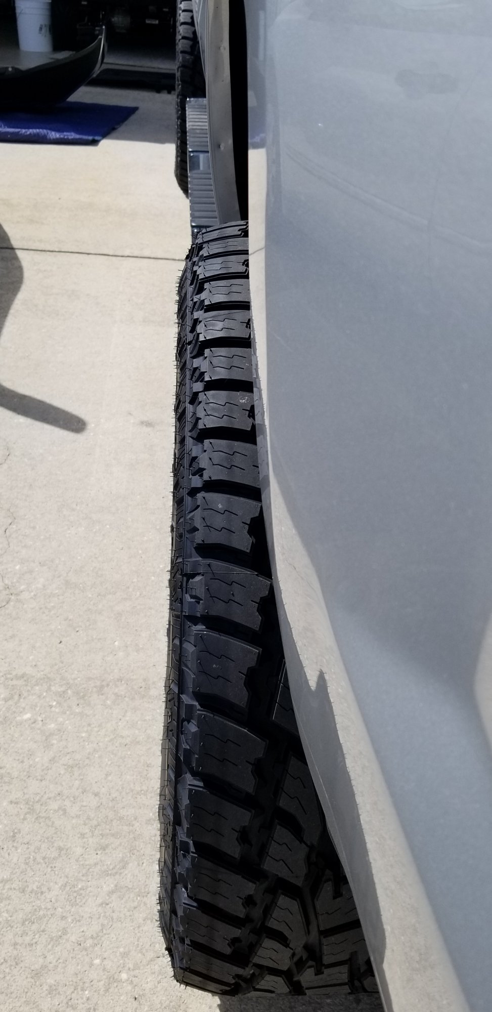

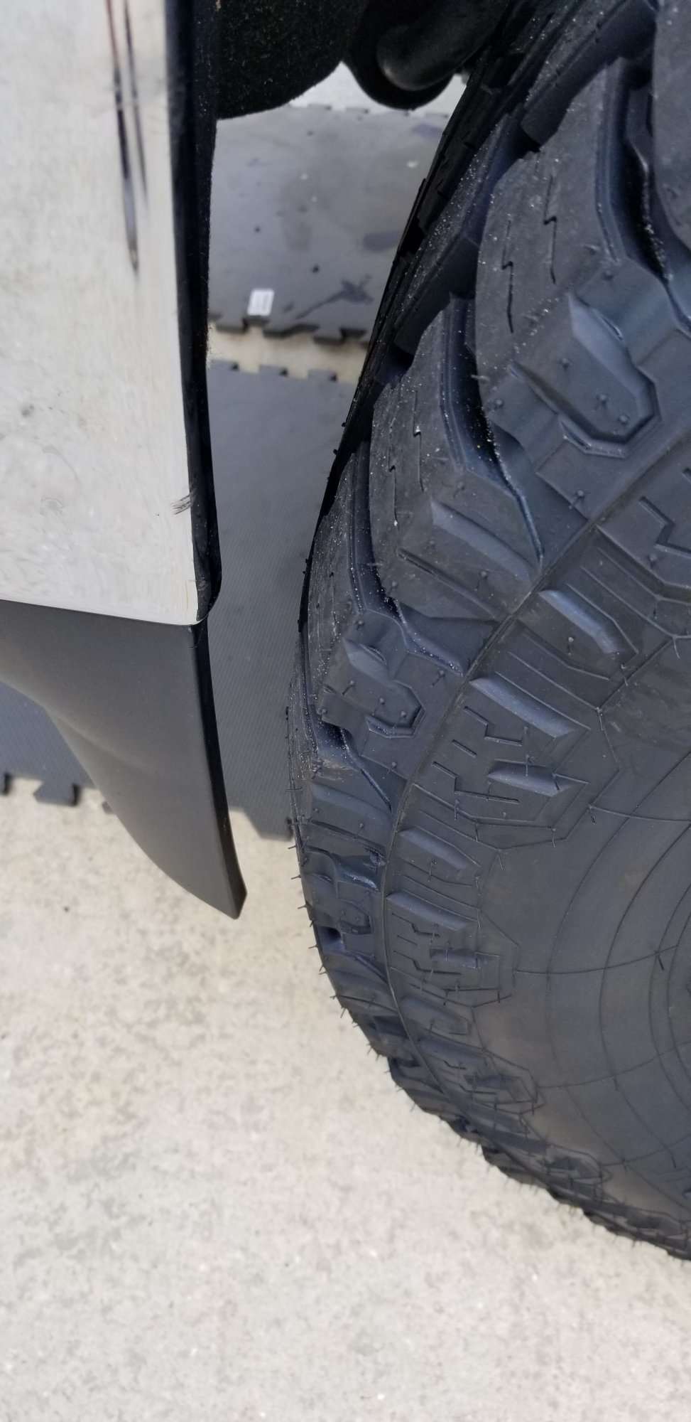

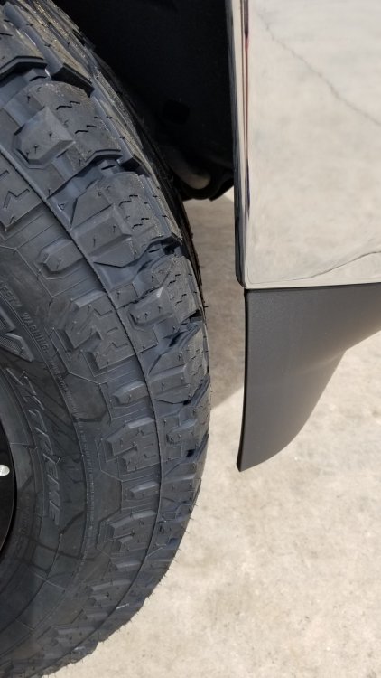

The 35"x12.5" Toyo Open Country AT2 Extremes fit perfect ! One side cleared the bumper completely, the other side just caught the lower valance.
Instead of trimming the lower valance, I shimmed the bumper out 1/2"  and no issues now ! Had to pull back the front felt on the inner wheel well, and remove the rear back corner plastic pc inside the wheel well, and tap the metal a few times with a hammer, and put the plastic trim back on
This is on a 0 offset rim !
Tires stick out the sides about 1-2 "
Here's some pics of the new ride with Kryptonite UCA's,  Suspension Max Leveling keys, shock extenders.
Truck rides better then stock! I love the ride !
The 2nd pic is the clearance before I shimmed the front bumper out another 1/2"
The closest the wheel gets when turning, Worse case if I hit bumps in the road and I hear the tire rub the lower valance, I could always trim now if needed.
The taller tires also helped with the UCA angle now on the Kryptonite UCA's
