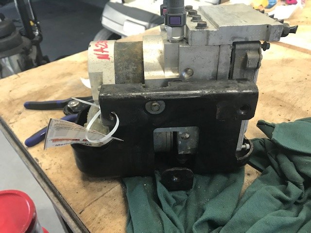

I have a theory on the brake issue. I had a eerily similar problem recently happen to me on my 2009 Tahoe and I ended up having to self diagnose it as the dealership guys have no clue what to do except start replacing uber expensive parts. Believe me if it is on your dime (out of warranty coverage vehicle) they will be happy to spend thousands in just a few hours and NEVER EVER actually pinpoint the real issue. It will be fixed but you will be bankrupt in the process. GM will NOT allow the dealerships to do this to them no more than I would allow it myself, so they are still searching to find the root cause and it seems to be putting a lot of people in true jeopardy from having insufficient brakes while they fumble along doing part restriction until they find a root cause and a economical way to do the repair.
Here is my Theory: Issue is the ABS assembly underneath all modern vehicles, it has an exterior mounted control module with electric solenoids. The  control module to valve body gasket is bad which allows water to get inside and onto the solenoids. If you read back through the posts you will see numerous people mention automatic car washes. These car washes are forcing water at the ABS assembly and the leaking seal is simply allowing water into the control module and shorting it out.  Usually happens shortly after driving though large puddles / fording deep water or going through your friendly neighborhood car wash.
GM could easily replace all these ABS assemblies as a whole but the cost would bankrupt them so it is a self preservation move to stall until they pinpoint the issue. Once they figure out the exact problem is just a 300 dollar control module they will replace the individual part and add a better 100% seal gasket and everyone can motor on safely. In the meantime all these vehicles should be parked NO JOKE!  Here are some pics of a typical control module that has leaked.
Once the water shorts it out you loose Power Boost / Stabiltrak and ABS functions until it dries out a bit but eventually it will not be able to reset at all.
Note to GM corporate: just direct deposit the 10 million that I just saved you
IMG_9401.jpg.feb20484c4c36f9b20335cd08a31b833.jpgIMG_9406.jpg.c239def75538adea3a9db0ee6b2810b8.jpgIMG_9407.jpg.400bded96db5426cb6a494e4ff72a895.jpg

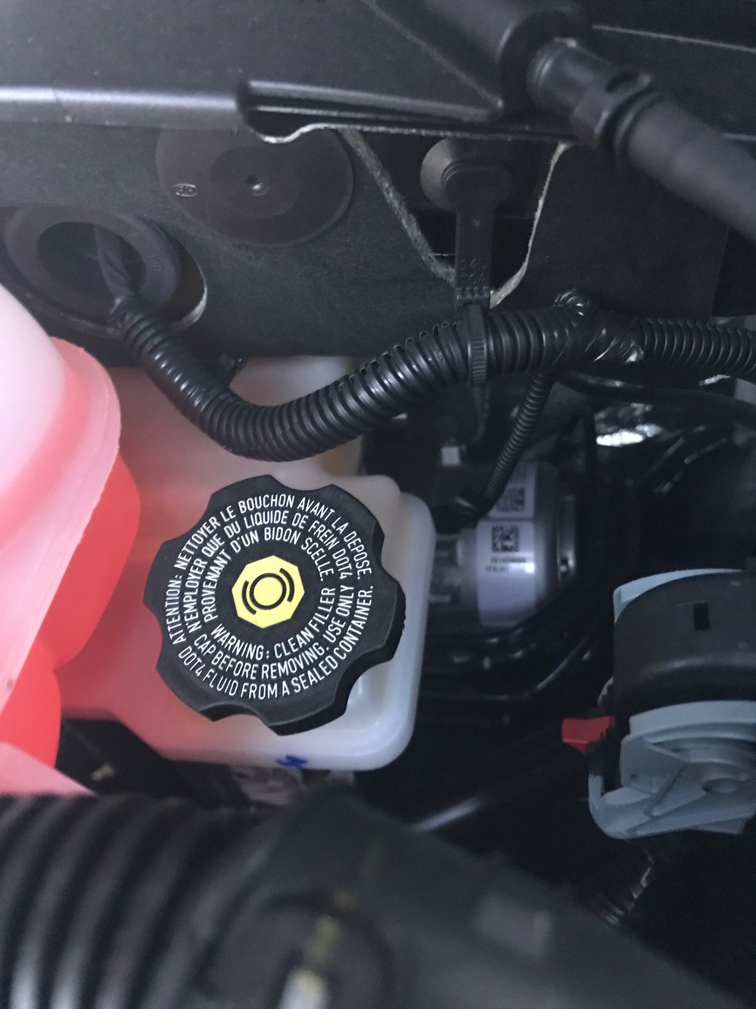

Looks like the ABS assembly is under the brake fluid reservoir.

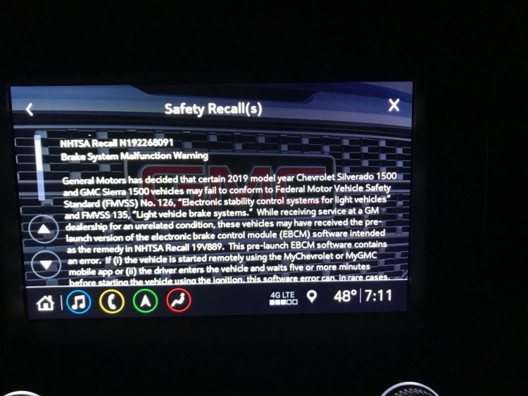

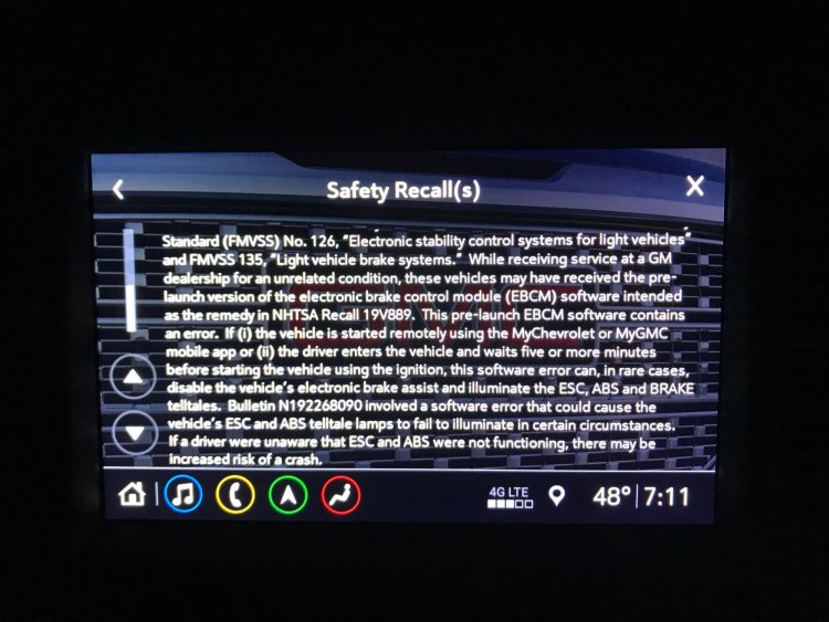

Was scrolling through the infotainment system and noticed this recall info in the MyGMC area. On the previous screen it had a date of Jan 30th 2020
