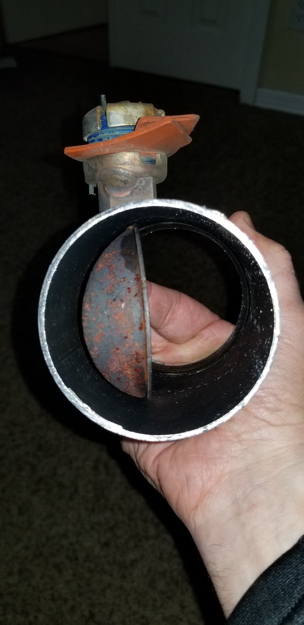

I have an AT4 with a 6.2. It has an exhaust flapper before the muffler and one after. I had them both cut off along with the OE muffler. I added a Magnaflow in it's place and left the 2 resonators knowing they could be removed at anytime. I think the sound is perfect and the total cost was less than $200. The flappers are the biggest restriction. When fully open they restrict the opening by 1.25" each.  See the attached pic in the fully opened position.
What type of magnaflow muffler did you use? Oval or round? 3" or 3.5"? Do you have a picture of what it looks like installed?
Those orange inserts only seem to be on the 6.2. the 5.3 doesn't have them. Is that for Anti-Rattle on the adptive valve?
