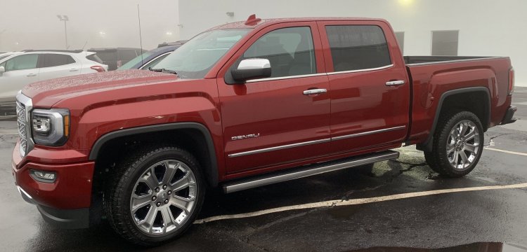

So as many of you know we completed most of our initial K2XX development on one of the very first production salable Yukon Denali's at launch of the K2XX SUV's. This continued with each minor iteration including another 2016 Yukon Denali for new feature integration and into other platforms with shared architecture from there on out.
That said it was time to return to our roots back to K2XX but this time with something different ;)
Say hello to our new 2018 Sierra Denali development vehicle! (and no we did not park it like this lol)
We will be using this vehicle relatively short term to finish some of the specific functions/features that have been requested but we were unable to fully test (we do not release anything we have not fully vetted in a long term test vehicle) so this should allow for some hopefully exciting new offerings.
Heres what we've done so far that may interest you guys (not listing the cosmetic stuff :))
-HMI Full Unlock, Video in Motion from USB, Nav Entry in motion, Vehicle config in motion, Rear Camera in motion
-Rear camera in motion thank to @pgamboa's fantastic super easy plug and play harness (and the above programming)
-Remote start run time extended to 20 Minutes per Cycle (40 minutes total).
-Fogs with High beams WITH Auto High Beams - Fogs work in BOTH modes. Those of you with Intellibeam know that simply pressing the fog lamp button kills the auto high beam function completely on a factory truck.
We have other things we are working on as well that are Truck specific as well such as cargo lamps available at all times (in motion etc).
Some of this will directly translate to T1XX Trucks as well and we have done quite a bit on those as well, we will likely grab a T1XX SUV for development in 2020 as well.
Stay tuned as we are going to have a lot of fun with this thing!!
