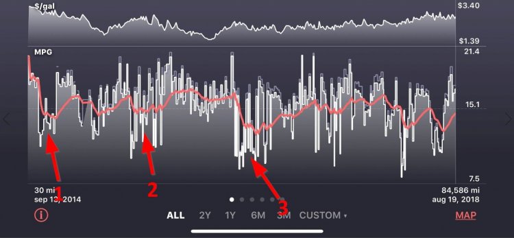

I can give you real world, brass tacks numbers on my 2014 CCSB 5.3L running 3.08's with a Leer topper.  The attached image is every drop of fuel that was added to that truck from the day I bought it in September of 2014 until the day I traded it in last September.  Over the life of the truck it averaged 15.1MPG
Of note,
1. Shortly after purchasing the truck we moved from Pennsylvania to Illinois.  I came first and the wife stayed back to sell the house.  I worked 4-10's through the week then spent my weekends making as many trips as humanly possible back and forth pulling the largest U-Haul pull behind the entire time.  I put 10,000 miles on my truck in the month of November 2014.
2 and 3. We bought a pontoon boat.  3500 lb dry weight including the trailer but stood about 6' taller than the truck and absolutely destroyed the fuel economy, especially if it was the slightest bit windy. (Think 9-10MPG on a good day, 6-7 on a bad one)  The lake we boat on is about an hour and 15 from the house one way.
I am not afraid to drive my trucks.  If I had to say, that's probably 70-80% daily city driving with the occasional trip to Florida or Pennsylvania thrown in.
*EDIT* If you look closely, the light grey line above the white line is what the DIC reported MPG was for each tank.  ALWAYS off by 1-1.5MPG
