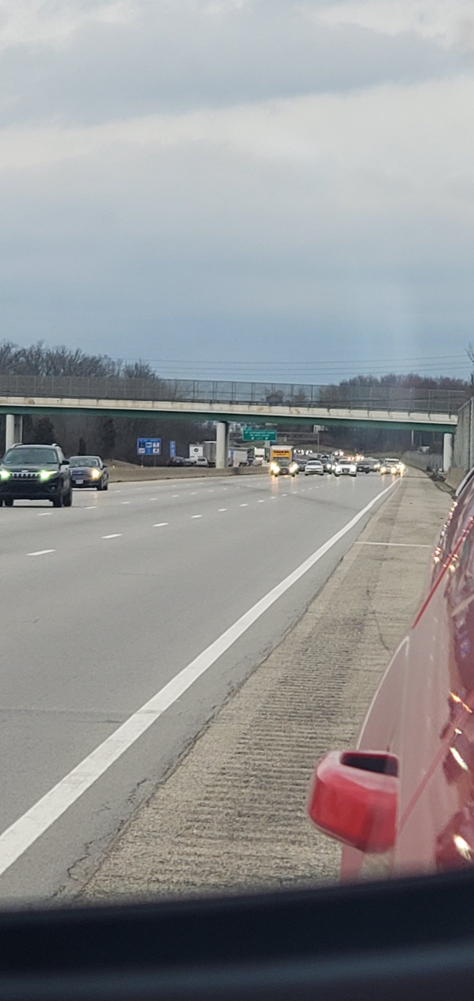

Ad80 I just checked no open recal on my truck for this issue. In the pic posted you can see the oil slick that dumped out of my truck on the freeway going 80mph I was in the fast lane and as you can see I had to move over to the other side of the road rather abruptly.  Luckily there wasn't high traffic.  Would have hated to see what would have happened if I wasn't able to get over as quickly. Engine could have seized and I could have been stuck in a travel lane with no way to get it off the road. Good thing it happened when I was driving and not my wife.

You might want to get an oil analysis done after they fix it because no doubt they will say no damage done and install the cooler lines and judging by how gm has been operating these last couple years charge you a 80 bucks for an oil change. How far back does that trail go, with how high pressure these systems are it doesn't take long to run it pretty dry imo.

Yes, could have been a lot worse. glad your ok.  Since there is no recall for your truck, and it still happened, then i guess it could happen to all trucks. I wonder if the dealers will still fix this, weather we have a recall out or not.
