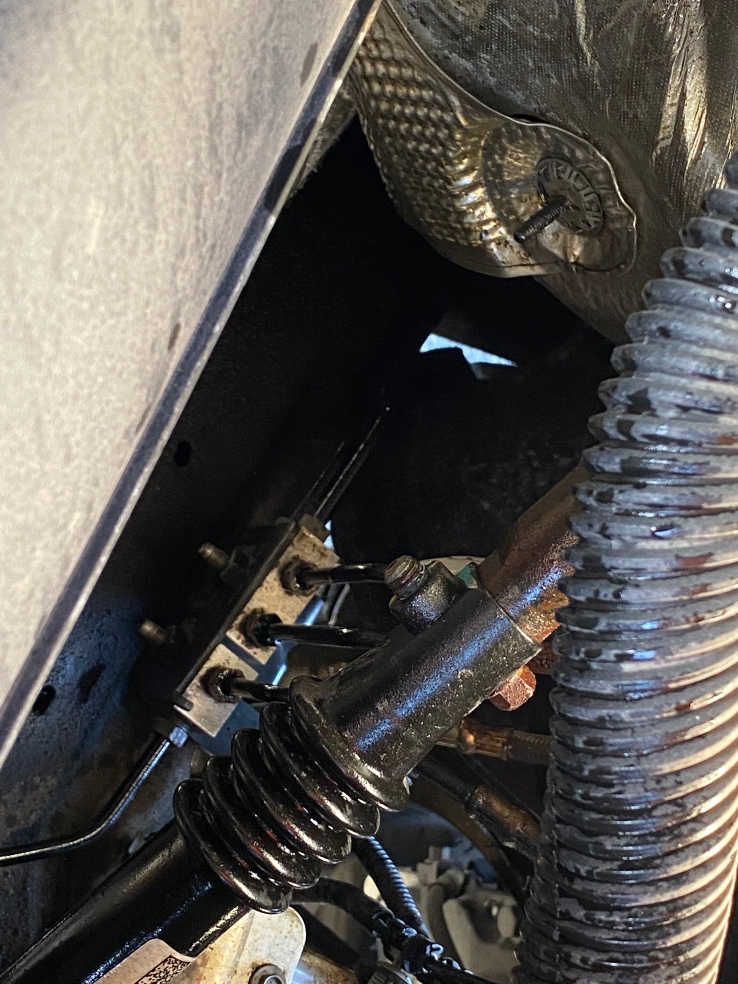

Mark me down for another failure. I was on my way home from work and got a code: "add engine oil". Thankfully I was close to my dealer, so I called and drove directly there. When I pulled into their lot, the truck was leaking oil pretty badly. The tech said the crimp had failed, but I was lucky because the hose hadn't blown off entirely. Thankfully, he has the parts in stock and is going to replace the lines today.

Was this the second failure on the same vehicle?? If so I don't get a warm and fuzzy feeling about the replacement hoses. Mine blew  (catastrophically) at 6K miles. Thankfully I was able to get engine shut down within 5-6 seconds of line blowing, but still dumped 5 of the 8 quarts of oil in that time. New line has been good.....so far
My 2019 5.3 with 88k miles was driving on I 80 in dangerous area 70 mph had a cel light on and all of a sudden no oil pressure started smoking shut off truck on highway in dangerous area .  engine is blown up crimp failure oil completely blew out.
Okay all..thank God for the internet. 2019 TrailBoss 28k miles. Left home, turned the corner…light flashing and no oil pressure. Pulled into parking lot and shut off truck. Oil everywhere on drivers side. 11 days earlier, warranty expired. 3yr/36k miles. Hopefully this is covered.
