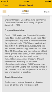

Same here. I have a 2019 new body style  Silverado LT Z71 with 55,000 miles. I caught it before any low engine oil lights came on. My daughter sent me a picture today of our driveway with a oil spot on it where I park. But same thing it’s coming from the hose or fittings right above the plastic shroud connected to the skid plate. The whole undercarriage is splattered with oil encluding the rear bumper. With all the oil splattered all over the undercarriage, the dipstick still showed full. I was able to limp it to the dealership from work. So I will be patiently waiting for the dealership’s call tomorrow.
My 2019 has just over 36000 miles, just out of warranty. Line failed, got the message to shut down engine. GM only gave me a partial credit for the repair. This is absolutely unacceptable. Because I don’t live in Alaska or Canada I’m not covered by the service bulletin, even though it’s been below freezing here for 3 weeks. Waiting to hear back from them if they’ll make this right. Truck is still at dealership waiting to be repaired, still waiting to find out if there’s engine damage.
