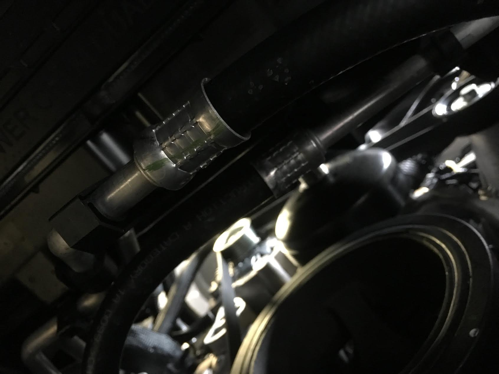

I've spoken to a good friend who is a 30 + year tech at a North Jersey Chevrolet dealer. So far he has seen two '19 Silverados with blown oil cooler hoses. He said to look for a yellow witness stripe that becomes visible as the hose begins to squeeze out of the crimp. His dealership is looking at each Silverado that comes in for the free oil change.
For the record my 9/18 5.3 Ft Wayne truck shows no sign leakage or line distortion at 6500 miles. There are green inspection stripes on my hoses as well.
Are they visible from the top or is this picture taken from underneath? Thanks for this information!

I have the same inspection marks on my lines.  Ft Wayne build date 12-12-18 Custom Trail boss Z71 5.3. 2900 miles no sign of failure.

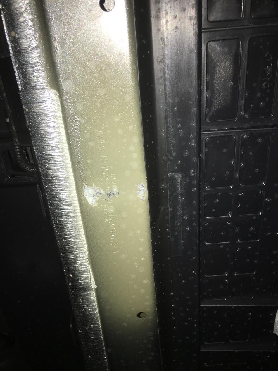

Roanoke, IN build. 400 miles on 5.3 DFM. Lines seem kinda soft to the touch, almost squishy. But no signs of any leaks or yellow marks. The green line is certainly visible. Couldn't help but notice the front cross member has a big ding in it, and only primer around that. Can't see it with the skid plate on but sheesh lol

Do the green lines indicate they have been tug tested? Or do any of the failed crimps have green marks too?
