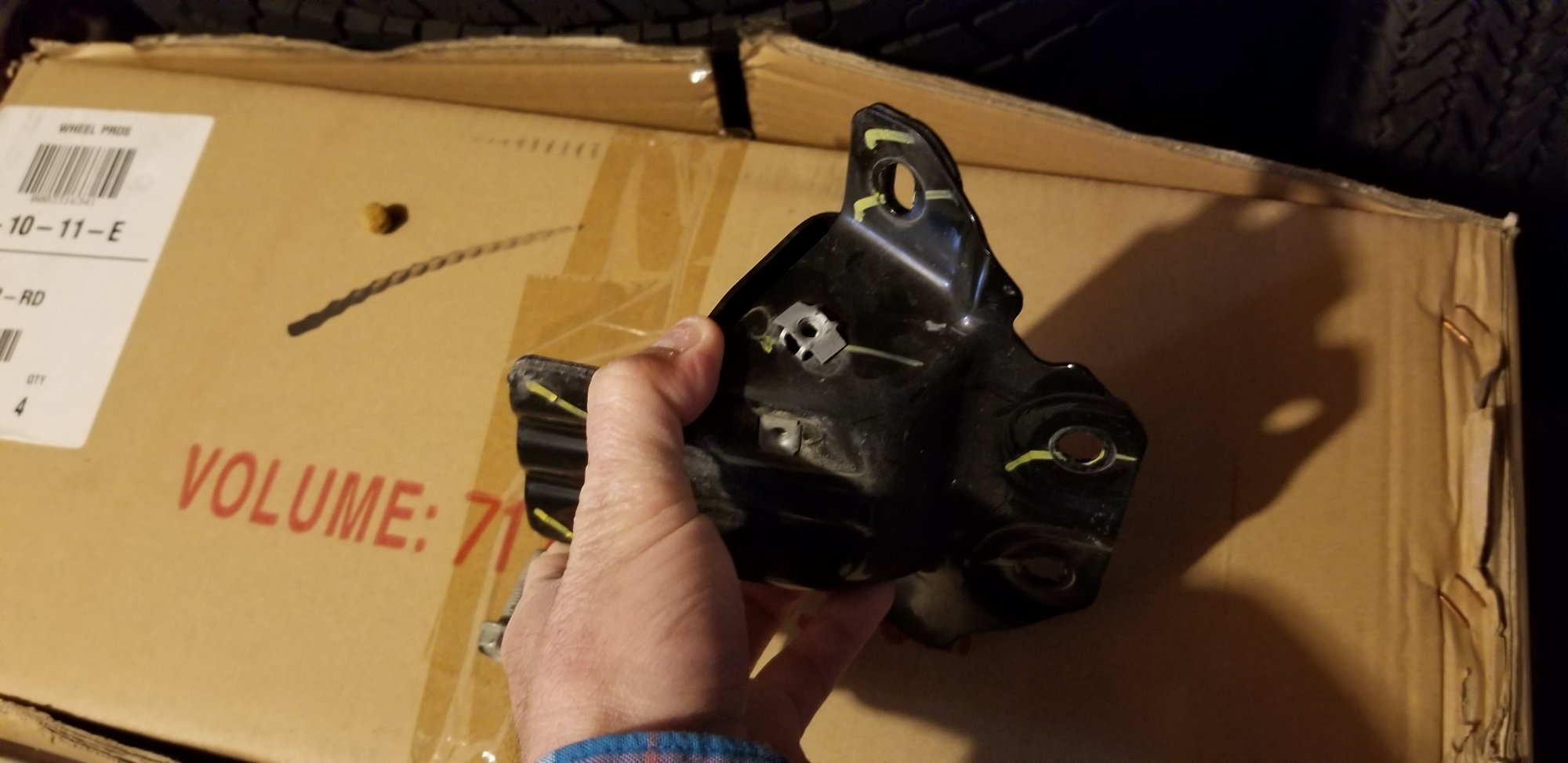

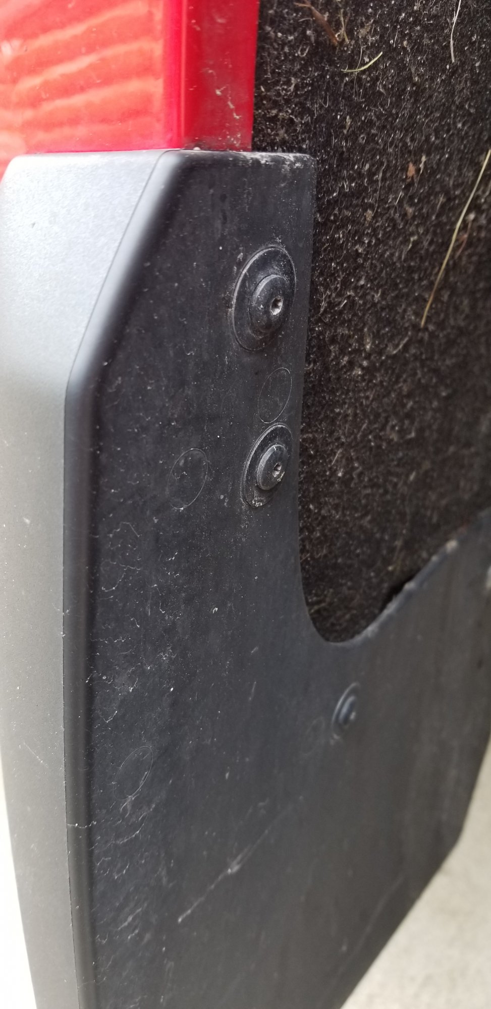

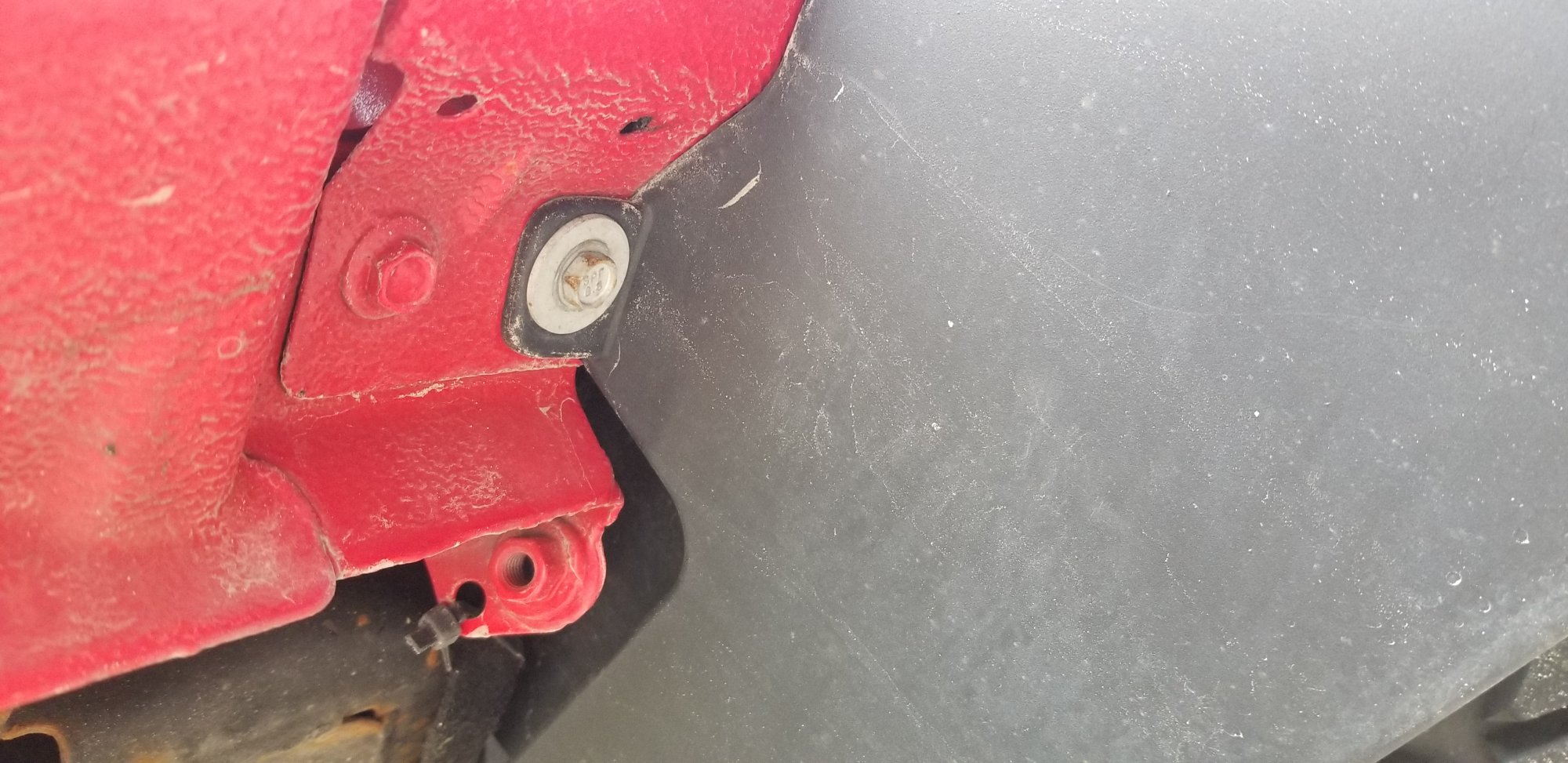

7 hours ago, BradenP said:
Awesome, really appreciate it, now i can order my tires !
First picture is the T-15 screws on the front of the mudflap.20190507_170559.thumb.jpg.89c61ef6dfba7178f3fbca7dbc252c2b.jpg
Second picture is the 10 mm bolt on the back side of the mudflap20190507_170605.thumb.jpg.ede72bd370381715220ba6cc85f960b3.jpg
This picture is of the zip tie point.
And this is the bracket20190507_170752.thumb.jpg.c82f066217aac36ab249aa470329d614.jpg
