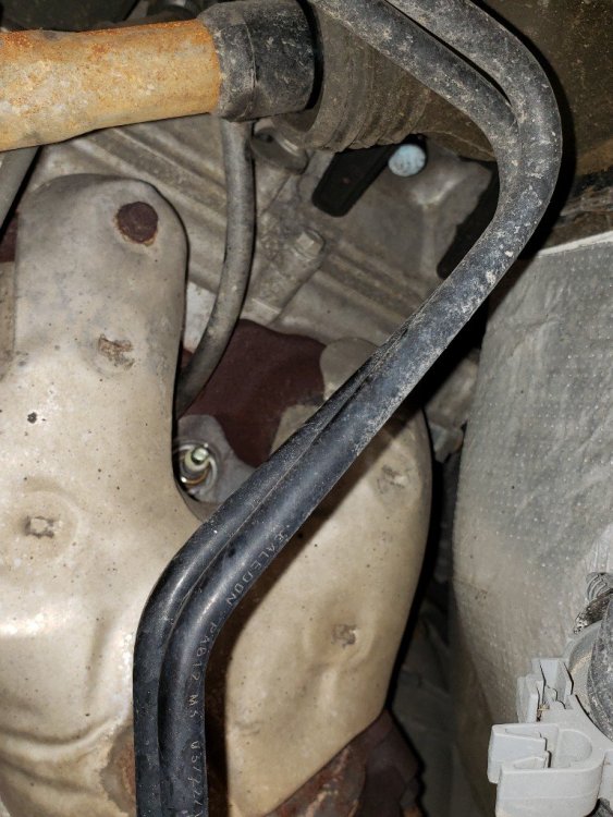

I put in all new plugs, started from passenger side, took the wheel and liner out. Pretty easy that way. Driver side back plug by the firewall was the last one I changed. When I went to pull the spark plug wire, it just fell out from the coil. There was green corrosion. Cleaned all that out and put everything back together. Went for a test drive and it was back to normal.
Glad it was an easy fix. I probably should have checked the fit on all wires before doing anything, since I assumed it was a misfire.
Also, the electrodes were worn down compared to the new ones. This is at 120k miles. They all looked worn down.
