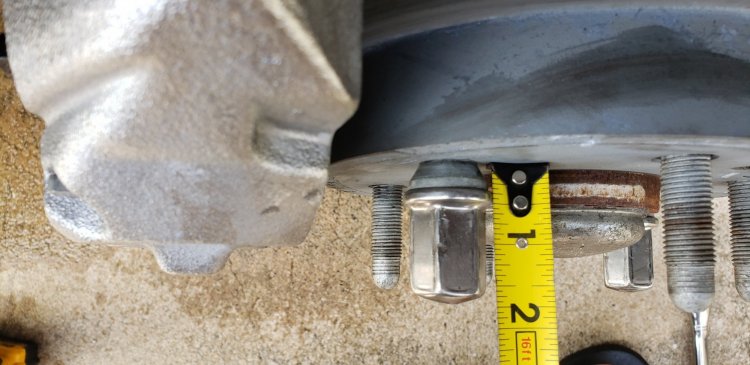

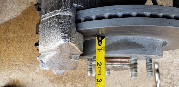

Could you get a measurement from the face of the rotor to the outermost protrusion of the caliper and the measurement of the wheel mounting surface to the same location on the caliper?  Might help us figure out if these will clear wheels before finding out we need spacers. Thanks.

Hey Bud. Just got done doing the swap on my 2006 Z71. Here are the measurements roughly.
Front face of rotor to outer edge of the caliper is 2-1/2" roughly.
From face of hub to outer edge of caliper is 1-1/2". If concerned about clearance add 1/16" to your figure.
I have 2015 Sierra 20" oem wheels on the truck. Tons of clearance with these.
