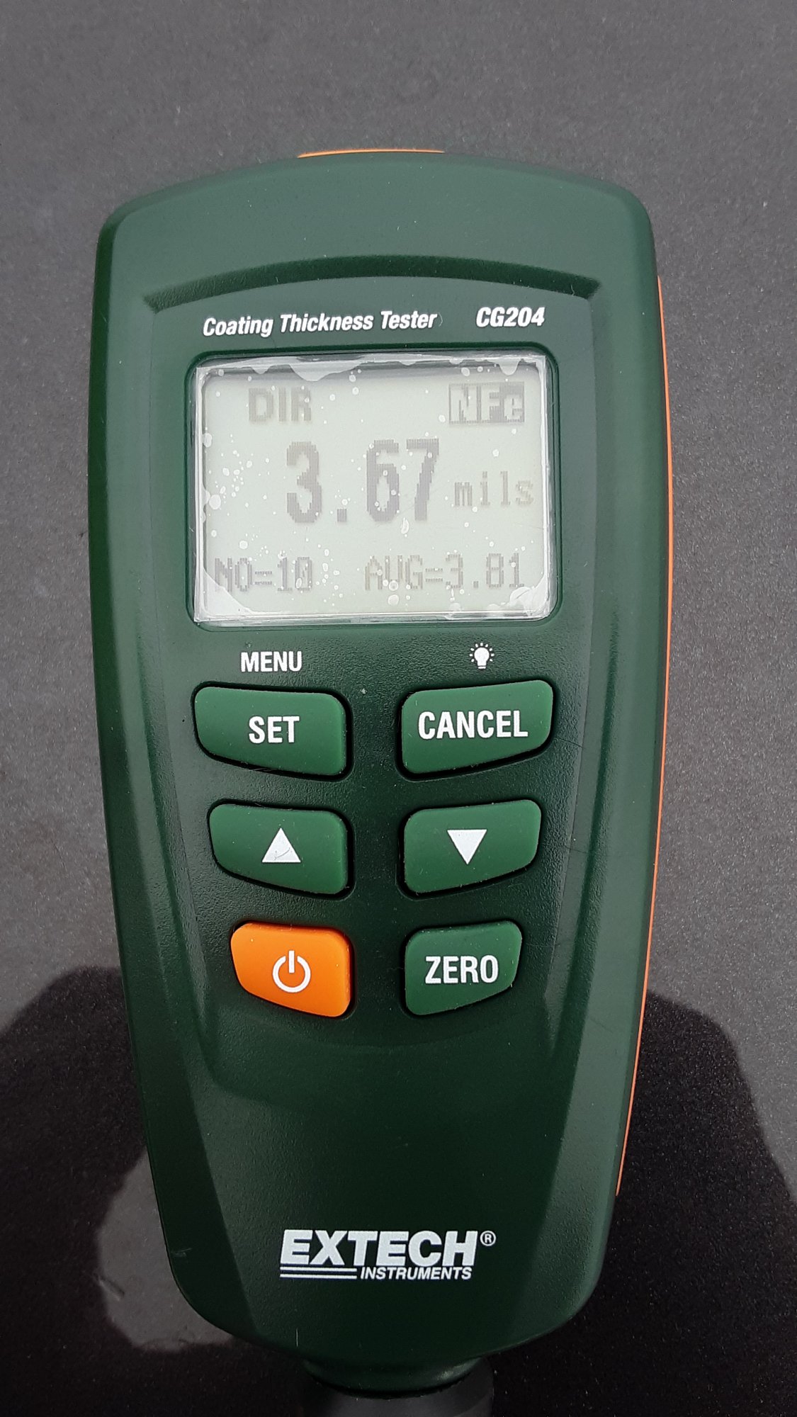

Wow, this is very interesting. I just remembered that I have a coating thickness gauge in my tool bag, I rarely use it. but I went out and took 10 readings on my '15 truck hood, both the leading edge and top. The average was 3.81 mils. It seemed like the thinner areas are along that front edge, where most chipping occurs. on top of the flat hood is more like 4.0 and above.
Then for comparison, I looked at my '04 grand am hood, that was around 5.0 mils average.

I would be curious to know what the sides of the truck measure as we see a ton of stone chips down the sides.
