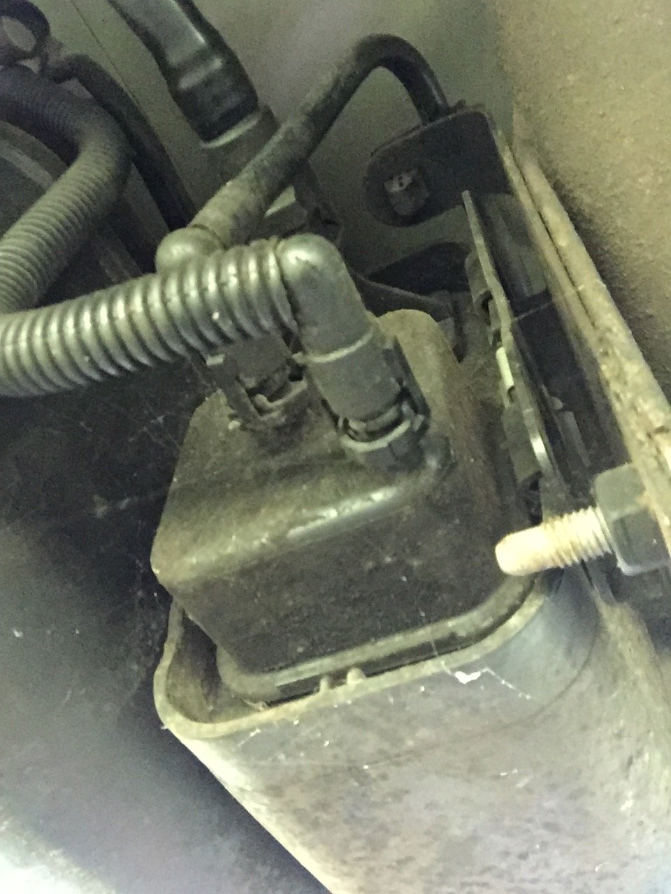

I've watched several videos and it looks kind of simple to fix the issue, except my truck seems to be different.  Most videos show a small canister behind the fuel tank.  Mine however has a larger canister in front of the tank - I think.  Am I looking at the right thing?  Two fuel lines seem to go to it.

Here is a picture of my setup. Haven’t seen anything like it online. This is in front of the tank.
Parts are readily available local and online.
There are discussions about a relocation recommendationfrom gm that moved items and pleaded the atmosphere intake higher up.
This was to resolve issues associated with overfilling the tank or driving in high water.
Both versions of the parts are available.
P0449 is an electrical issue with the vent solenoid  ( the pic is of the canister not the solenoid ), wiring or pcm.  Most likely the solenoid but needs to be diagnosed. The solenoid is hidden behind the driver side of the cab. Between the cab and box. Kind of a bitch to get to.
I found it. On top of the gas tank it looks like. How on earth do I get to it ?
