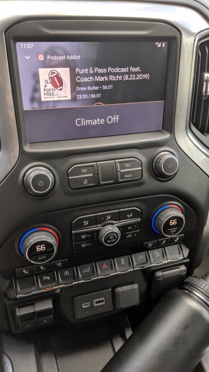

Downloaded quicker than it took to post this pic.
#@$&&@$ Climate Off is back ten days later grrrrrr
