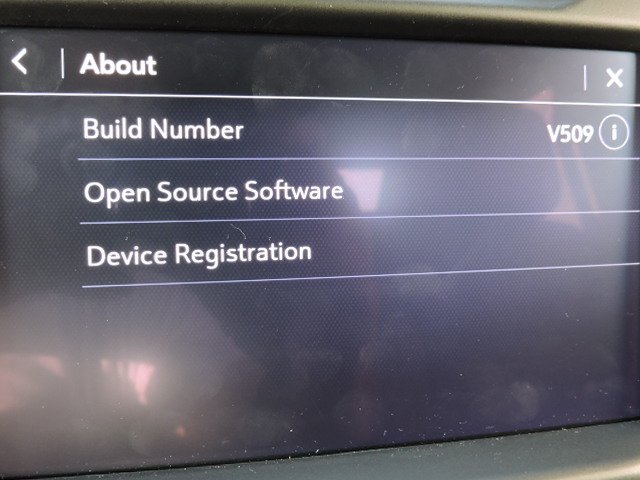

I checked my RST IOS system tonight. I’m on 803. It said no updates available.
But I haven’t had any issues with mine, other than some odd Bluetooth connection problems from time to time.
Just checked and the update is available for my truck now. I'm going to update after I get to work in the morning. Hopefully I can stop unpairing and repairing my phone every other drive. [emoji120]

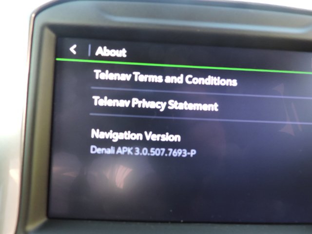

Had the Nav upgrade installed today updating the IOS to IOT and the new update version is v905 with a footer that it is a Denali number.
Appeared to be using OnStar, probably for the traffic and accident updates.....Stopped OnStar under Applications Running and the maps and directions still worked and had to redo the Bluetooth and make OnStar secondary for making calls. The speed limit sign next to the speed in the main cluster was working, but slightly different, just the number for the speed limit minus the words like in the Traverse.
Display is not as colorful as the older OEMs using the HMI module, but still a lot better than the Google maps under Auto Android. Even with the Nav chewing up 267 Mb of memory, still room to add more apps. Seems to have corrected the Climate Off bug.

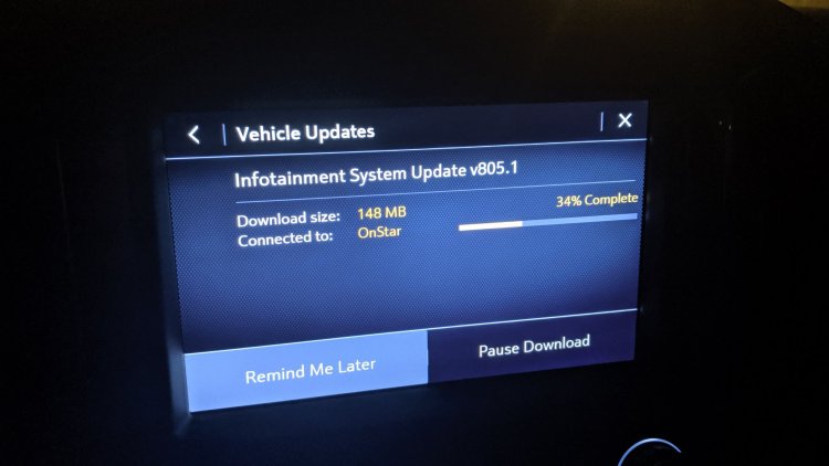

    • when it's greyed out that is it's way of telling you that it's downloading the patch in the background. Eventually it will be fully downloaded and then it will prompt you at ignition shut down to run the update. I highly recommend doing the update once you get home and can run it a few times. I've had several issues with updates not going the first time around and I had to retry the update multiple times in my driveway before it was successful.   Some updates are huge and take awhile to download. You can help it by connecting to your home WiFi and keep the truck on service mode for the ignition and keep it alive for awhile on a battery charger too. There are specs it needs to be in for updating such as a full enough battery charge, no running ignition, etc.
