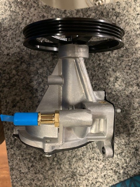

This recall however does not take care of the known faulty Vacuum Pump. Faulty Pump recall came about a few months back where they replace the pump if
a loss of braking power is detected.
This software update is a band aid quicker and cheaper fix than replacing the root problem.
Aside from a possible loss in braking power...……..when the pump goes, it causes metal shavings to enter the oil system thus possibly grenading the engine.
Which is another good reason for replacing the newer upgraded Vacuum Pump.

i have replaced two brake module/vacuum pump/booster assemblies on the 2019s already. its an all in one unit. the only part that is separate is the  fluid reservoir. they have software issues. its all electronic.
1 hour ago, 15 Z71 said:
I had  got a letter saying they would extend the warranty for 6 years or 72,000 miles for this issue. My question is if I take it for this re program and have the pump go out down the road will they still repair it if I'm under the special coverage? Or should I just wait until my special coverage is getting closer to running  out? Or they going to try and say the re program is the fix the letter means nothing now?
ok the special coverage is for a faulty vacuum pump which is a mechanical pump attached to the engine. this is not a  recall. the recall is a reprogram of the EBCM software. two separate things. now i think gm is thinking if they change how the abs/ebcm uses the vacuum will prevent the pumps from wearing out. as a tech who has change 50ish of these pumps under special coverage i believe its a lack of proper oil changes, its attaches the engine and supplied oil from the oil system. people dont change their oil properly. wait til its says change oil soon/ or 0% or going 1000s of miles pass 0% oil life. I KNOW what is the point of the oil life monitor system? well its to inform you to change your oil but its based on software that uses an algorithm based on engine use/conditions. i have a 2018 sierra. i change my oil every 5000 i dont wait for the truck to tell me.

So there is a newer style pump? If so, is it hard to change out?
