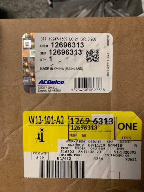

I posted this on another thread but wanted people to know what my dealership told me when I brought my 2014 gmc for recall. They said that that vacuum pump part number 12669488 is being replaced by a new pump. Part# 12696313. They quoted me over $600 to replace pump. I brought truck home and said I would do it myself. I was able to order this new pump part # from an online GM dealership out of North Carolina. Still waiting for it. But it appears to be a new part as I could only find it from GM dealerships. Amazon or rock auto didn’t have this part only the superseded part. I’ll post a pick of the new pump when I get it. I have no clue what the difference between 12669488 and 12696313 is. I found one on eBay from a dealership and they both appear exactly the same from the pics.

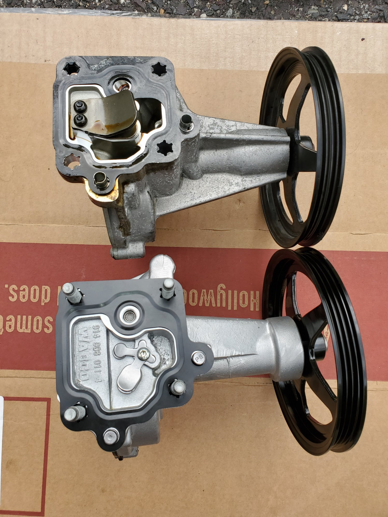

Looking forward to the pics of this new part number.  For reference below is my faulty original compared to the 12669488.
Wouldn't let me upload both to the same post.
