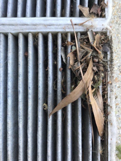

Depending on where you live to me changing out the cabin filter once a year might be needed.  At least here in the eastern part of NC.  The yellow pine pollen in the spring can clog that thing up fast when you are driving through clouds of it blowing off the pine trees.  My 2002 had 14k miles on the cabin filter in just over 2 years and it was nasty.  Plus if you are like some and you don't drive much I have seen people change them out and found a nice nest on it from mice.

I agree with the point that the cabin filter needs changed, possibly before you might think.  I changed the cabin filter in my Equinox and it was much dirtier than I though it would be.  It was easy to change.  I will be changing mine every year.
Interesting was the YouTube video that I watched showing how to change it.  In the video, there are acorns on top of the filter.  Obviously critter intrusion.  But the worse part was that the person said if the nuts fall into the system, past the filter, good luck getting them out.  Again, a good reason to stay up on this maintenance item.

ok so as a tech for a gmc dealership the issue with the cabin filters on the 14-18 model trucks/yukons is they get alot of a debris in them from the vent on top of the dash having larger then normal vent holes. i have changed cabin filters at 7k due to lots of debris in the filter. i highly recommend to do it ever 10k on these vehicles. the air filter typically around 20k-25k. fuel induction service is recommended about every 15-30k.
they arent trying to rip you off. its maintenance, you have the right to say no. you also can change the filters yourself.
