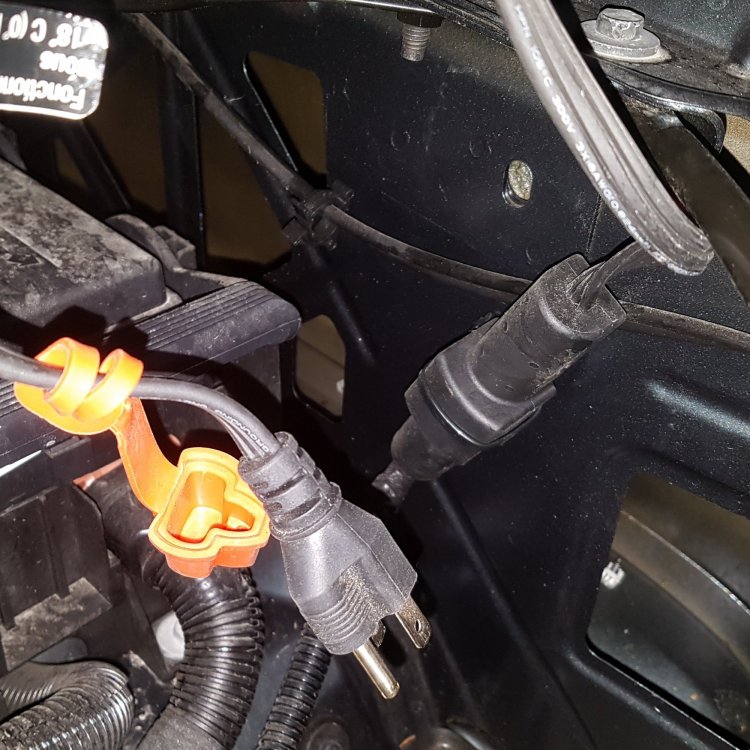

I just recently picked up a new '19 Legacy, and was checking out the block heater cord as it's that time of year.  It appears to have a normal plug, without the temperature sensor.  Has GM gone away from these, or is the temperature sensor somewhere else?  The manual says the thermostat may exist in the plug end, but I figure that's because the Duramax probably doesn't have one.

I picked up a block heater tester on the way home today and it was showing negative when I plugged the truck in at 0 degrees Celsius. Then I noticed the little module part way down the block heater cord, attached to the inner fender. Maybe they just relocated the sensor because plugs tend to get damaged and replaced.
