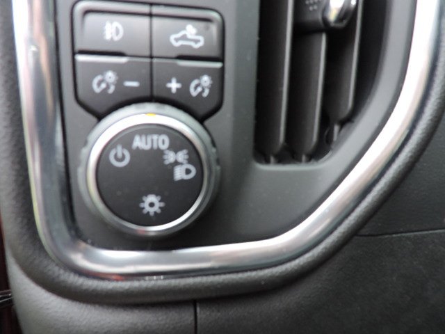

The screen brightness on my 8" infotainment screen can be controlled at night with the dash buttons used for LED back lighting of the instrument panel. I find it necessary when using the Nav at night to dim the black background of the night screen.
And the HD camera and HD screen (convenience II package) and stock halogens in the backup lenses provide more than enough lighting and contrast for backing situations in total darkness although the lenses of the rear taillamps provide a faint geometric pattern on the pavement.

My 2020 trail boss with the convenience package 2, I turn the instrument panel brightness down about 50 % and my back up screen is not to bright. I have an LT loaner base trim truck right now and when I tried backing into driveway at night I was indeed blinded by the light of the backup screen. I didn't look to see if the base Lt has the buttons to dim the info screen but ill check next time I drive it.

On my 2019 LT, the dimmer button does nothing to the screen when the backup camera is on. When I put it in drive, the "regular" screen (radio, climate, etc) respects my dimmer settings, but whenever the backup camera is up and I'm in reverse, it's full on stadium lighting.

Screen dimming may only work on the optional HD camera and HD radio screen, definitely works with the same two -/+ buttons in the lighting cluster controlling dash back lighting. Will noticeably dim at night and really helps on Nav and backup camera screens.
Yep, those were the buttons I was trying. How can I tell if I have an "HD Camera" or not?
It comes in Convenience Package II on LT and RST and standard on the higher trims. If you have an SD card reader next to your USB ports, you have the HD rear vision camera.
