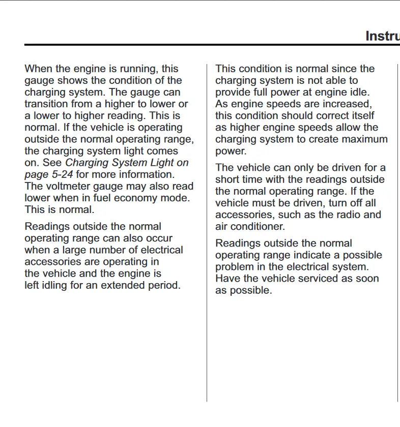

The charging system on this generation of trucks/SUVs ('07 and up) only charges when needed (alternator doesn't supply a steady charge to the system as older vehicles do).  You'll see the voltage meter fluctuate (on my '10, I'd see it down around12v and up to around 16v).
I doubt the LED light strip is causing the voltage fluctuation and CEL to come on.
Need to get the codes read to see what is causing the CEL to come on.
