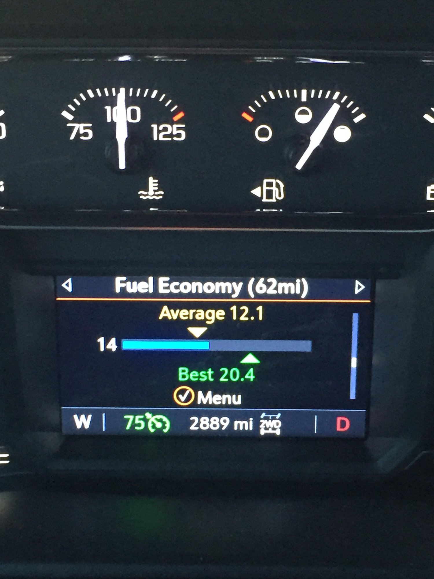

What can possibly be wrong with my truck. 100% stock, 22” stock tires.
averaging 12-14 mpg on the highway. This is all highway no stops, 75 mph cruise. Many trips show the same result.  Both direction neglecting wind. All the same.
All past 6.2’s with the same driving habits get significantly better mileage. Not impressed with my 2019. Past trucks and Yukon 6.2 get 20mpg without even thinking about.
Thought with the 10 speed and new fuel management it would be better.

Does the hand calculated gas mileage match what you see there? Even though I have a 20MY with 5.3 10 speed. I posted in another forum that with the 10 speed I'm turning lower RPMs than my 16MY truck 5.3 6 speed. I'm not getting any better gas mileage though. Same driving habits and route to work.

His dash also shows 2,889 MILES, not KILOMETERS.  It is in the LCD portion of the display so should switch back and forth between miles and kilometers, unlike his coolant temperature gauge which has permanently printed text on the cluster.

I live in Canada. Truck bought new in Canada. I switched the display for the picture so Americans would understand haha.
Runs 17-20 L/100km and this is on the highway for the whole tank. These tanks are so small I get horrible range. Can’t imagine towing.
Also the picture above is using American 3.78 L to gallon. Canadians use 4.54 L per gallon, which I never use when calculating mpg and hate when ppl do. As it gives a false higher mpg.
