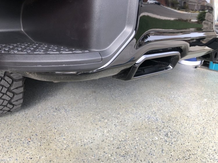

Pulled my exhaust tips and had them powder coated. Only cost $40. I would highly recommend doing that over buying a new set. You are going to have to pull them to replace them so pull them drop them off to get powder coated and then put em back on. Got the call mine where done about 2 hours after I dropped them off.
How are they holding up? I’m assuming they had to sand or scuff them up first? I’m thinking about sending mine off for powder coat too.
Only been about 3 months but holding up great. No idea what they did I just dropped them off and picked them up. $40 total.
Pictures?

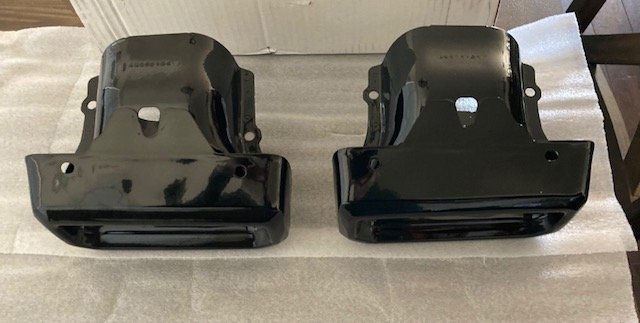

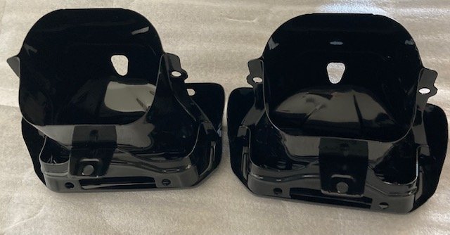

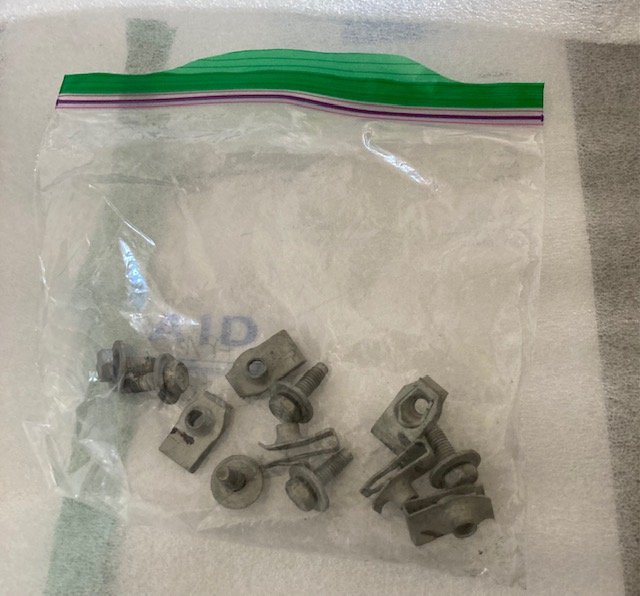

Hello Everyone, I have a newly powder coated gloss black set of stock exhaust tips.  They are perfect and include all stock hardware.  Price shipped to your USA location is $150.  Message me for info and photos.SOLDSOLDSOLD
Edited by Mac-427
Damn, wish those were satin.

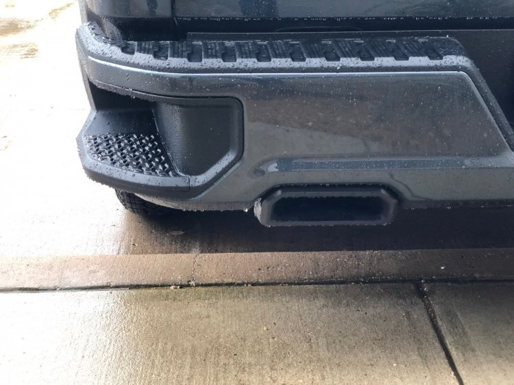

On 7/21/2020 at 2:10 PM, Transient said:
I've been doing some digging on black exhaust cutouts in the rear bumper. I ran into a dead end on GMPartsDirect. Turns out GM does make some. I found them on a Midnight Edition Silverado Trail Boss. I wasn't able to grab its VIN, so I went to Chevy.com and used the build & price tool. When I clicked on the Midnight Edition package I noticed the truck's exhaust cutouts turned black. I then finished the build and clicked on the button that allows you to search available inventory near the default zip code GM's website input. I was able to find a midnight edition Silverado, and wrote down its VIN number. I then took the VIN number to my local dealer to find the part number. They gave me the part numbers, but told me the parts are on backorder. Nobody near to the dealer's search area has them. I then jumped on to GMPartsDirect on my cell phone and searched the part numbers. They are below. The result revealed these are for the Carbon Pro Edition GMC Sierra. I checked the compatibility for the Silverado, but GMPD said they aren't compatible. I get it. Go look for these without a part number and no VIN and all GM sources say these don't exist. IIRC, the price for the black exhaust cutouts are about $10 more each than the chrome ones on GMPD. I want these for my Northsky Blue Trail Boss, so I'll dig a bit further into this to find out how long the backorder is. I'm trying to eliminate all chrome from the exterior of my truck. Hopefully this helps somebody out.
Left Side: 84644535
Right Side: 84644536
I just received the tips for the part numbers listed here. They are indeed FLAT BLACK, not satin. They are like Rustoleum flat black.
Edited by Diamond817
