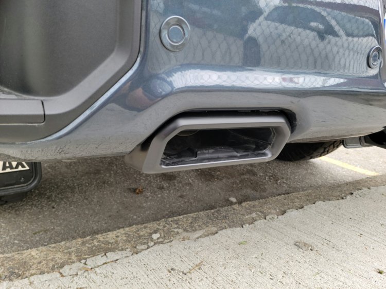

Tips pictured here are primarily stock oem tips ??

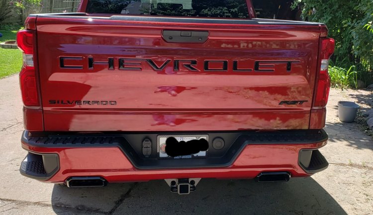

I had a mine powder coated the first weekend the truck was home.  Cost me $50.00.  If you have a factory trailer hitch installed the only way to access the 2 top bolts is to pull the steps.  Simple process but a pain.  The factory hitch takes up all the room underneath where you would slide you hand up to loosen the top bolts.  I really like how the blacked out look worked on the Red truck....

it really looks good how it matches your other badging!
however, just in case it helps someone else (unless the silverado is different in some way) it is possible to access those top bolts without removing the side steps. And actually I found getting those side steps off was a major pain! there are plastic clips that hold them on, likely so they will snap into place on the assembly line before the screws are installed, those clips bend back behind the bumper so they will not pull out. one of them is accessible with a pry tool, the other two are completely impossible to get to. I had to cut them off in order to get the step pocket off.
to access them without removing the pockets, you'll need a gear wrench, its quite possible to get a gear wrench on the bolt heads and remove them.

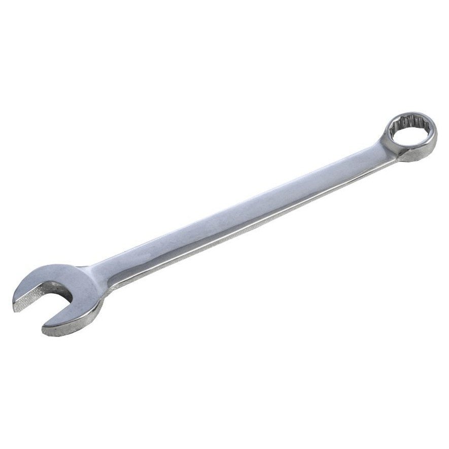

I did mine without removing the side steps because of the blind spot sensors. I used a 10 mm wrench like the one in the pictures and went 1/2 thread at a time.
It can be done but it's time consuming. And also done forget to paint the bolts clips because if you let them unpainted they will be visible on top of the black tips.
Good luck and watch out for your knuckles....hahaha.

You can buy a ratcheting box wrench at Lowe's.  It's made by Craftsman.

Did you do a gloss black on those tips?

Yes, I went with gloss black and it turned out great.  Been on there a month and a half and still look great.
