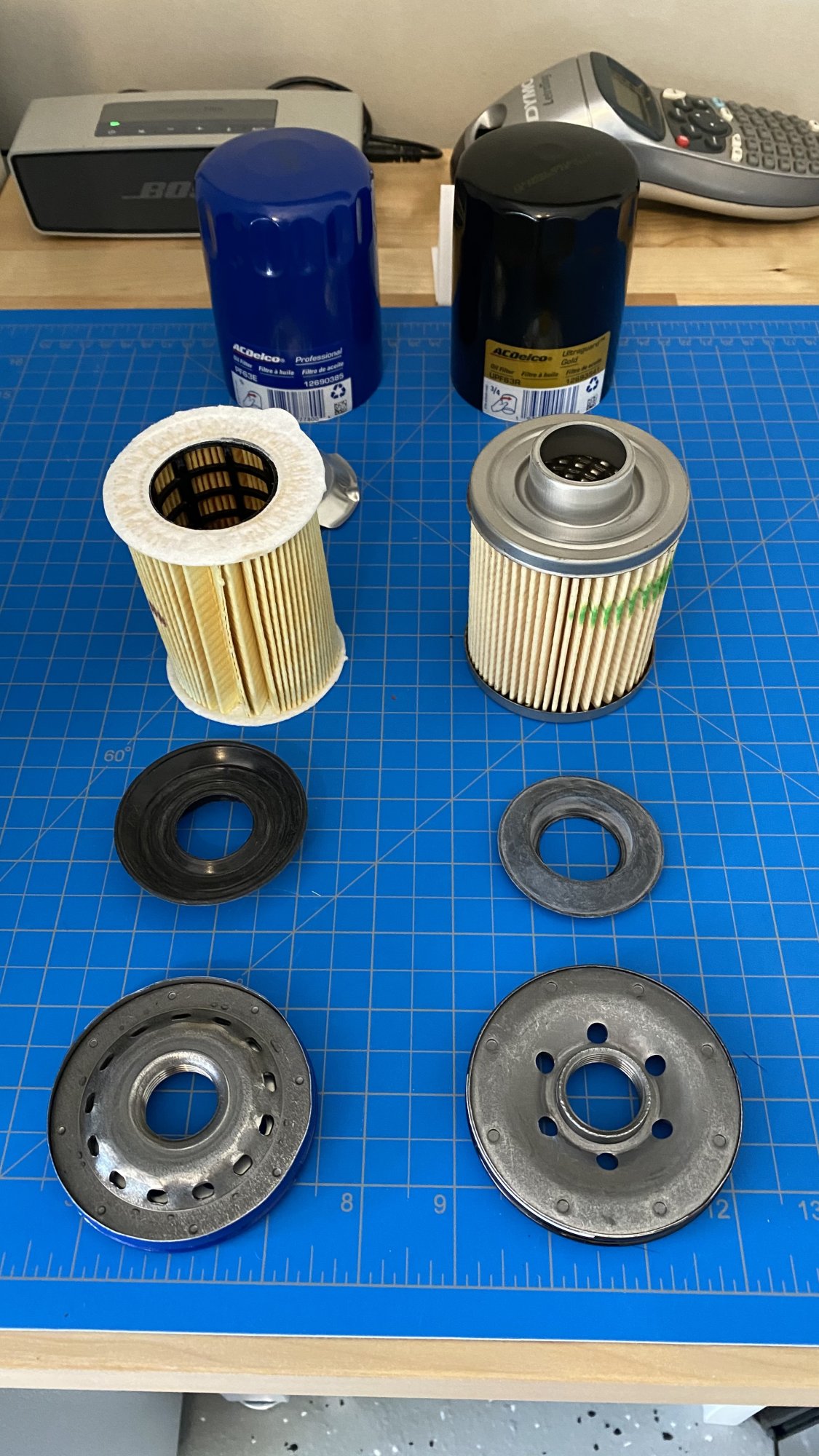

Decided to have a look inside both the 63E and 63R...R has thicker can and tighter media and metal end caps. E has the core and ultrasonic end cap installed and can was thinner.Visually the R wins this contest but the E definitely matches the super tech filters inside and out.

While cutting open filters is fun and informative it can't tell you how well it filters.
UOA's that include cleanliness testing can.
Read the filtration post.
