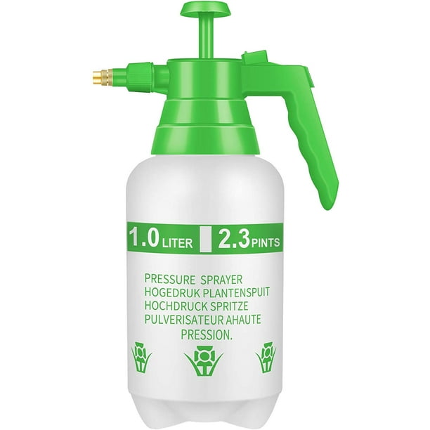

Fill this up and spray down with straight Super Clean. Do not dilute. This is easier than a spray bottle.
iPower GLSPRYBOTTLE1000 38oz Hand-held Manual Pump Pressure Garden Sprayer Bottle with Adjustable Nozzle for Lawn, Garden
I use this because you want to keep everything wet before you rinse. If it dries it's harder to remove and may leave residue.
