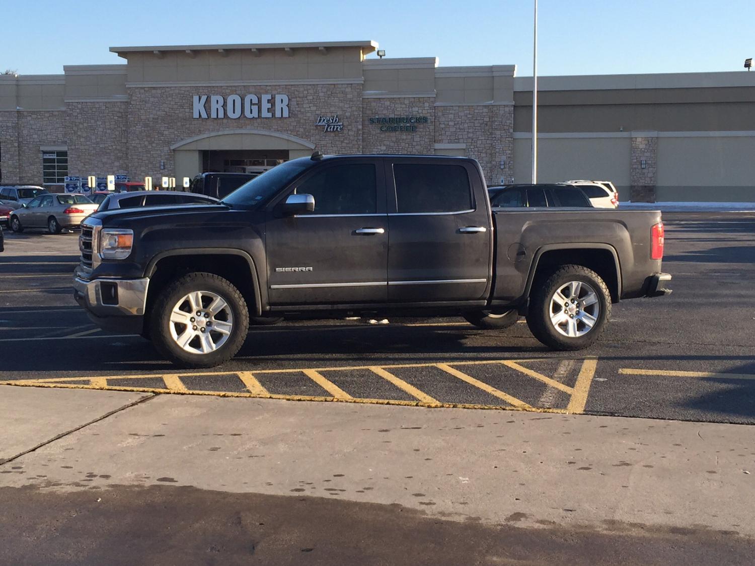

Here's a picture of my truck. 2014 iridium metallic crew cab SLT 4x4 non Z71
Stock wheels with Nitto Terra grappler 275/65/20 wheels lifted up front with a eBay 3/4"=1.5" of lift bottom strut spacer and I have the 5100's set to the second notch to achieve another 3/4" lift. The rear is still factory block which I do want to switch out soon. To me it looks like the front is sometimes a little higher.
I do rub very little but not enough to be concerned about.
Wish I could do a 4" lift but they are too much $$
For people that are concerned with MPG, which I am too, I am still able to achieve 19-20mpg on average going about 65-75 mph. I lost about 1-2mpg on average, which is nothing in my opinion.

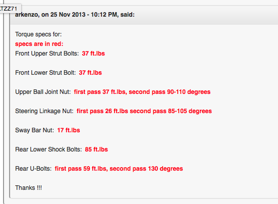

Question on torquing bolts after install of a leveling kit.
I found this in a previous thead(I think this thread), it states "second pass 90 - 110 degrees". Could someone explain that to me.
Thanks
Thanks
It's an overkill. The bolts that secure the bottom shock to the A-arm is not so critical that would require precision torquing. But to answer your question, here is a link.
http://user.xmission.com/~kd7olf/torque.html
