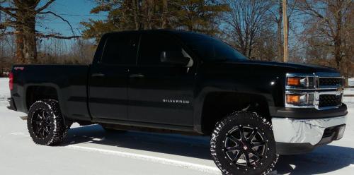

I have spent 3 days reading 179 pages I think I've finally decided on a 2.5 rough country front only with stock rear block, I want to run 18" fuel maverick rims with Toyo Open Country MT and I want my tires to be wide and to stick out just a little with NO RUB what size and offset should I run? I have a few sizes in mind below
275/65/18
275/70/18
285/65/18 <<
Thanks in advance
2014 Silverado 4x4
I would definitely run the 285/65/18. As for offset, +1 or +14 in the 18x9 maverick would be my choice. Probably the +1 for me. Edited by Aldila
After talking with Mr Wheel Deal I was told a 12mm offset will set my wheel flush with the fenders giving the tires a little outside the fender, if you run fender flares the 0mm might be better. I went with 12mm for mine just waiting on them to get here now.

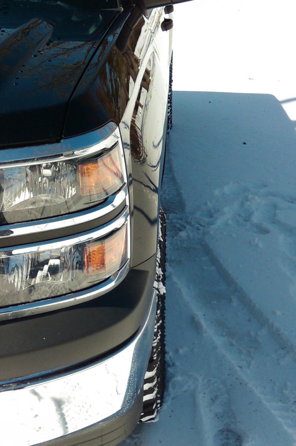

Assuming you're talking about a 9" wide wheel. Some guys on here run 9" wide with +1 on the fuel mavericks and barely poke. I would consider a little more offset if you want the tire to run flush with a flare. Lots of pictures throughout this fourm!

I went with the 12mm so If I want it to stick out more I could add a small spacer. but if I like it more in then I wouldn't have to get new wheels.

1.5 zone body lift . 2.5 summit performance leveling kit front only 20-9 ballistic anvil +12 offset. 33-12.50 r 20 atturo trail blade xt no rubbing.factory 36 front 39 rear after 41 1/2 front and back.
