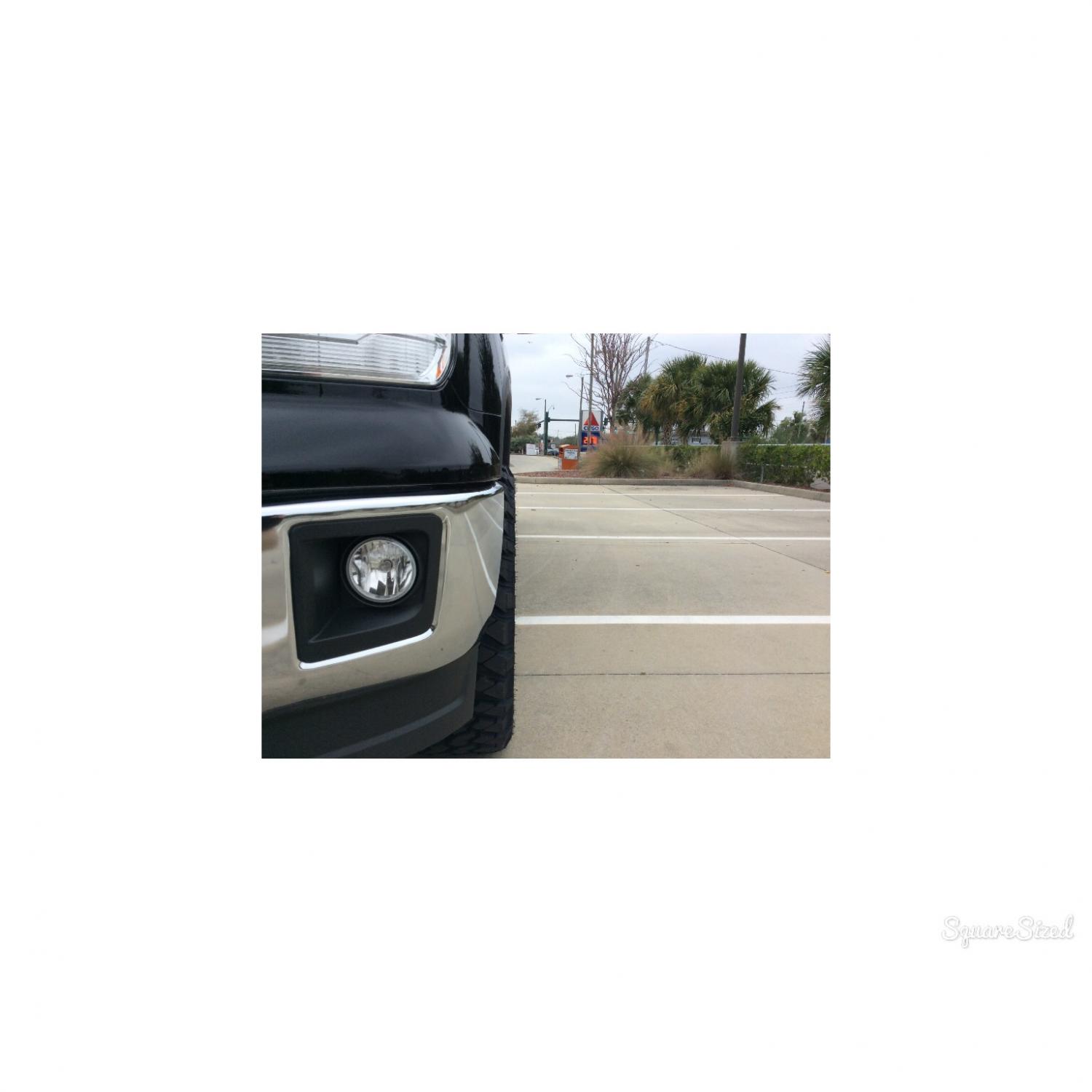

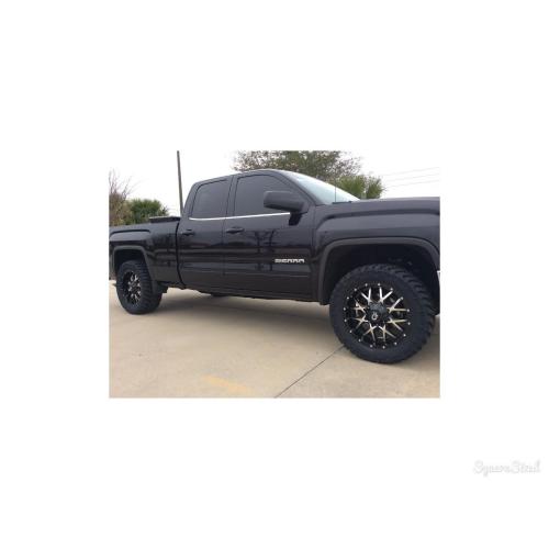

2014 Sierra
20x9 Dropstar 645MB +18 offset
295/55R20 Nitto Trail Grappler
2.25 Pro Comp level kit
Absolutely in love with my truck and can't stop looking at it!

Looks really nice. any rubbing?
