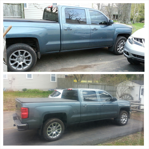

2" bottom spacer installed up front and a 2" rear block (1" block removed) out back on stock 20x9 wheels with 275/55/20 tires (for now)...
Grid picture is before (top) and after (bottom)
