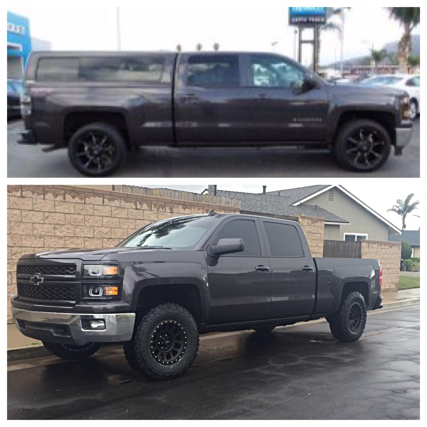

Thanks!
It's a Motofab 2" level kit in the front with the 2" block in the rear. Also have Hellwig 987 helper springs which lifted the rear about a half inch.
I don't have measurements at the moment but in the end it raised the front by 2¼" and the rear by 1½ so I lost ¾" of rake which seems perfect to me. Tires are 275/60R20 Duratracs. They did rub the carpet and I was shocked because I read that this size was safe even at the stock height so I can only attribute it to the aggressive tread of the Duratrac tires. There's a pic I posted yesterday of the trimmed carpet liner - I did not want to use zip ties. Thanks again for the compliment!

Sorry to keep asking questions. I don't see any pics of the trimmed carpet on this forum from yesterday, or the past few days. I even searched your name. Sorry if I sound like a stalker. Are they posted somewhere else?
I agree, I'm shocked too to hear it rubs, even if just a little. Not what I've been reading about 275 60 20's. With the trimming, would you do the same size tire again, or go down to stock 20's in a Duratrac?
