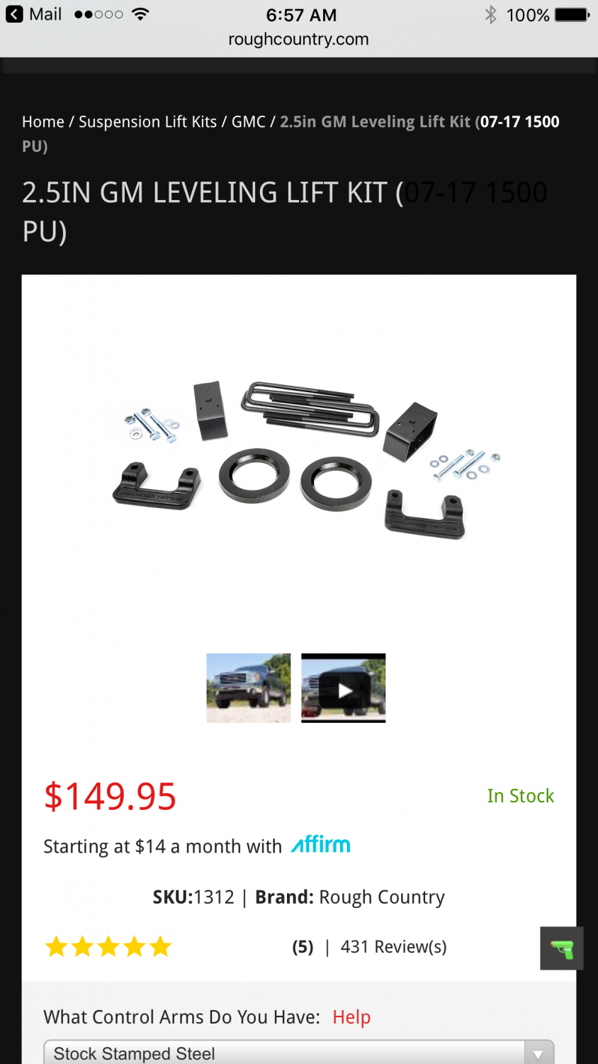

That was from rough country themselves. Stamped steel arms now have a inner .5 spacer that goes on top of the spring(not on top of the strut like before) due to the balljoint angle with new arms was even worse with spacer on top. I emailed and called to verify.
See here I selected stamped arms, the top spacer is now a circle. See the part number? Now in second picture it says strut doesn't need assemble but excludes that part number. Like I said before, the rough country rep said they changed top spacers for stamped arms to help the geometry/angle a little better apparently.
I almost bought this kit. Then I called rough country to ask them about the spacer. Said it was a preload spacer and I had to disassemble the strut to install. I said screw it just went with the pro comp 2 1/4" level.
