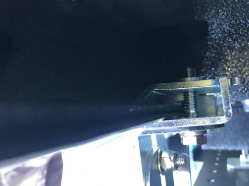

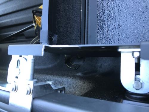

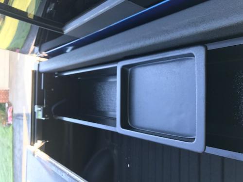

OK the little BakBox2 that I ordered to go with my FAC G4E came in late yesterday. Was a real PITA to make it fit up (took a little bit of field engineering). If I had not had several extra bed cover rail clamps left over from when I did the Peragon cover last year I would not have gotten this done at all. (I got lucky on this one) Also I did have to notch the end rails at the top slightly to clear the FAC latch mechanism.
I do like the fact that you have room to actually reach past the fairly narrow BakBox2 into the truck bed and retrieve items. It looks like on the FAC personal caddy that it fills in the entire panel space and you cannot access the truck bed at all when only the front panel is open just the personal caddy which could be an issue if you have stuff that has slide forward under the tool box.........
I utilized the tiedown anchor point with a Peragon clip and 1/4" bolts/flat washers with nylon locking nut to hold the end closest to the cab of the truck. This is a difficult task as you have to carefully pre-assemble everything and mark the hole location to be drilled in the tool box end bracket to make this attachment and (must be precise).
I used a Peragon rail clamp and clip to hold the tool box end piece at the back end of the toolbox, this was easy the parts just bolt right up. (just very lucky that had these laying around)
When you mount the tool box end pieces be sure that the top of the pieces are slightly below the bottom of the FAC striker bolt, you will still have to notch the pieces to clear the FAC latch edges I took the existing notch 1" further towards the rear of the truck.
Oh and the BakBox2 videos are a bit misleading the silly thing really does not fold all the way up. The front panel does fold down and makes a nice little shelf but it does not fold all the way back and stand straight up. It just falls back down into the shelf position with nothing to hold it because the front piece is folded into the bottom LOL If you look closely you will see whn used with a BakFlip cover it is mounted 8 or 10" back from the front of the bed (Wasted space)
With the TriMode steps this is going to be perfect. Too bad the BakBox2 is such a Pain to make fit with a Fold-a-Cover G4 Elite, once done it is really pretty cool . If anyone wants to make an attempt they will need some rail clamps brackets and clips bolts etc. Good Luck Men here are some pics.
