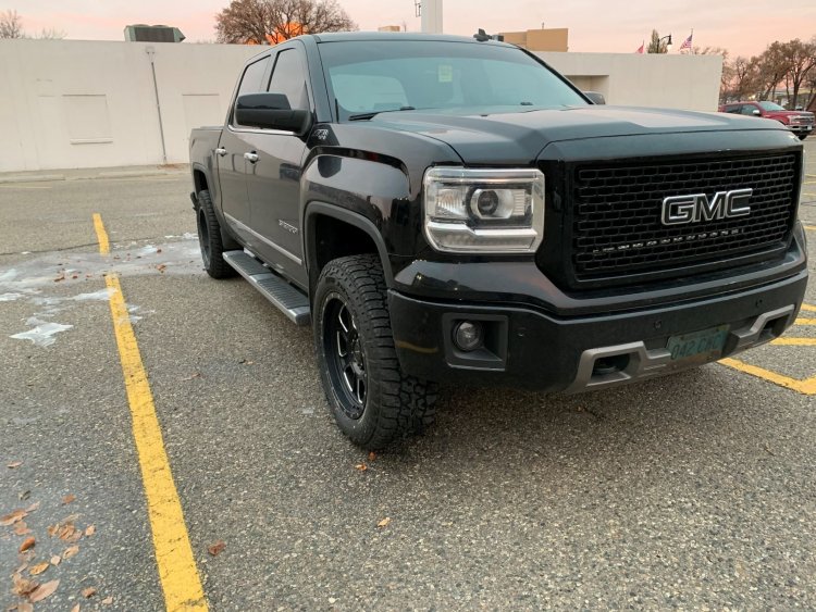

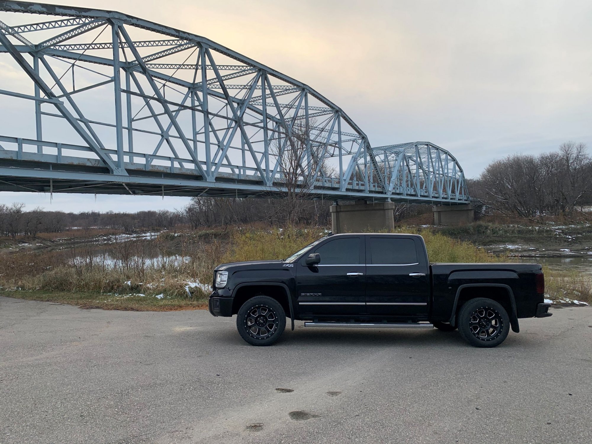

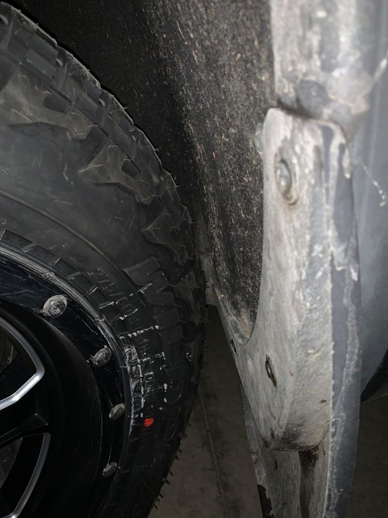

Falken Wildpeak AT3W are on! Went with a 275/60/20 (33") on Pro Comp 20x9 et0, Bilstein 5100's on max setting (1.85" of lift) up front. It's very close to the mud flaps at full lock in reverse, going to do some trimming tonight and see what works best. Happy with the results so far! Hard to keep this thing clean as old man winter is here ?
