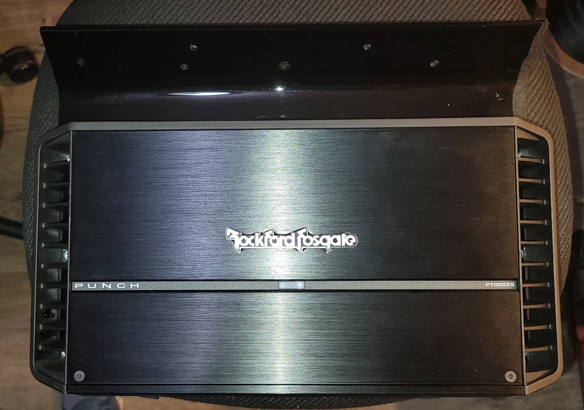

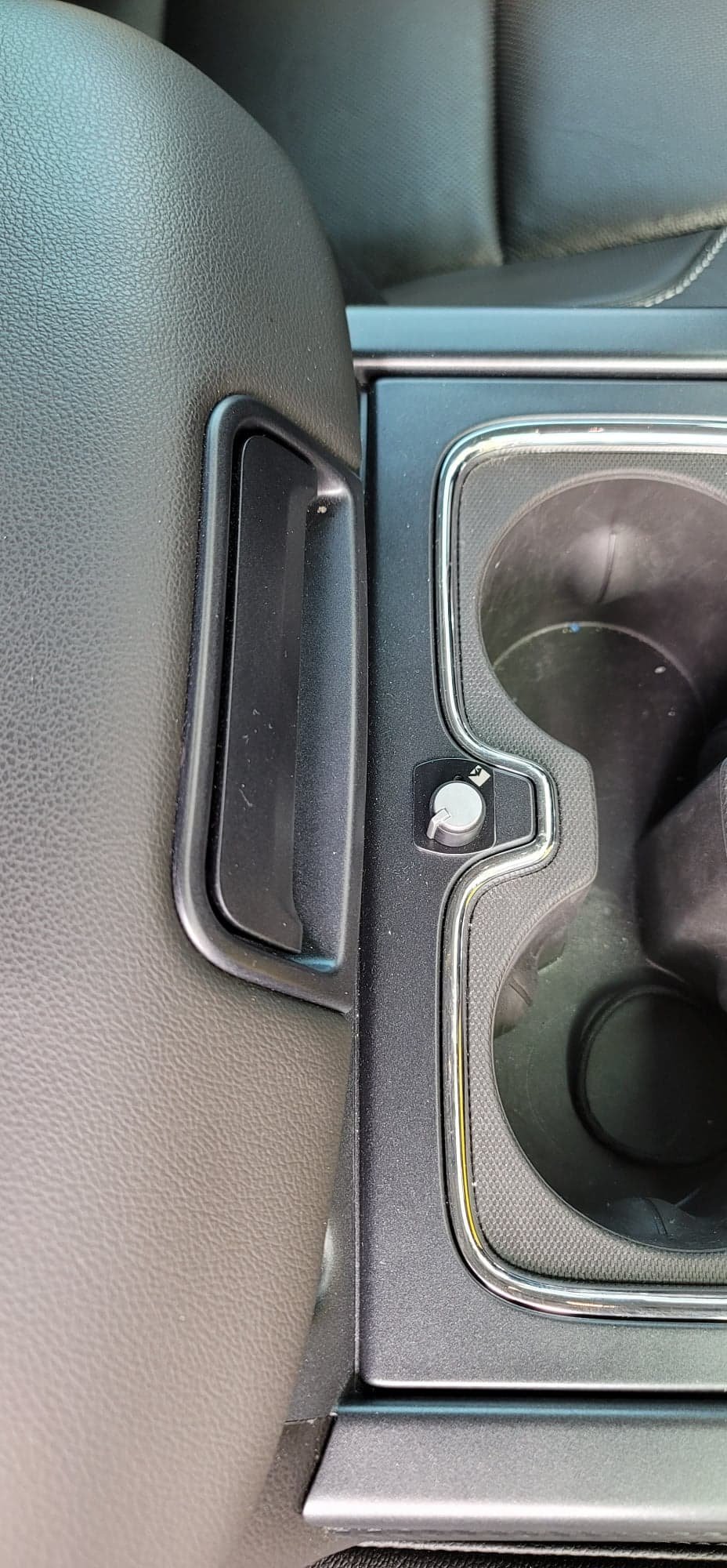

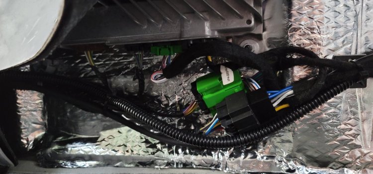

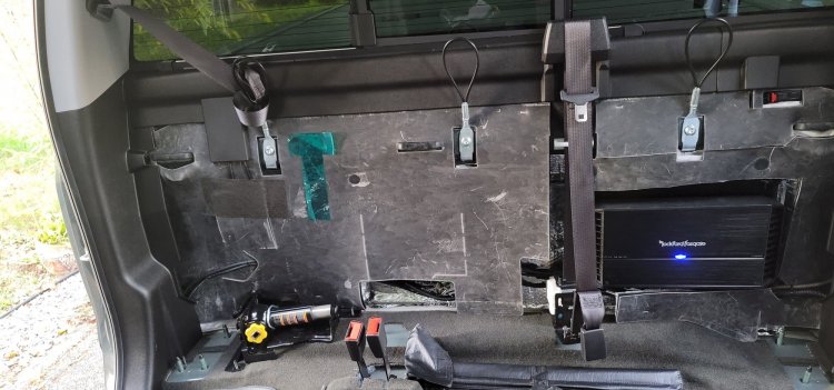

I installed the AmpPRO AP4-GM61 to get rid of the bass roll, used with PAC APH-GM02 AmpPro bypass haness, makes for a clean install. Running my setup off a Fosgate P1000x5. Put it on a plexiglass and bent(heated it to bend) the top so I can bolt it on via rivet nut to the back, worked out great. Runs my 4 doors and the sub great. I left the front dash to the Bose amp. I get chime and everything. You can adjust the chime loudness via Ampro AP4-GM61. I also mounted the bass knob in the center console, work great.

There's 3 harness included, I only used one for the Bose amp to bypass.I have the Bose system.

Yup. Second picture in my post, you can see the amp where I connected the bypass harness to it.
