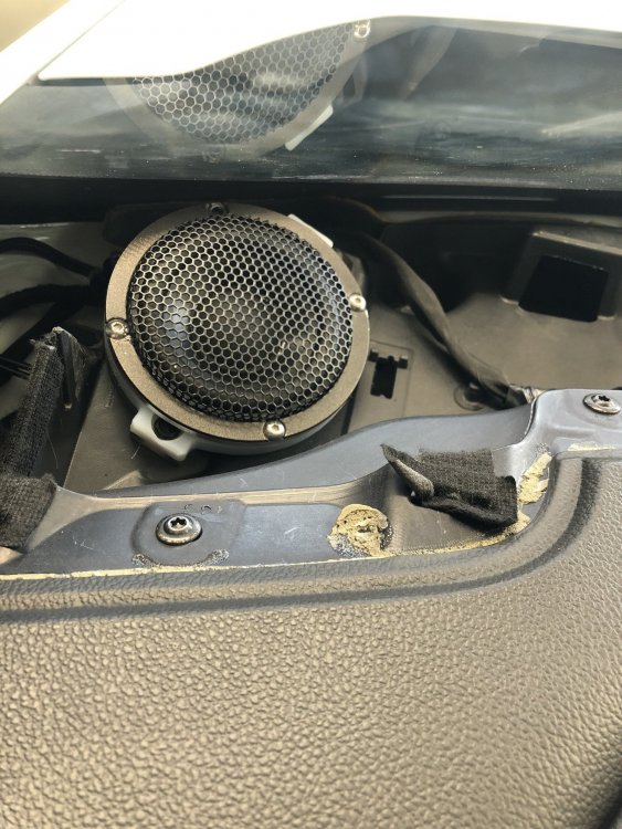

Attached is a 3" mid in a Sierra dash.

Those should sound great! I am focusing on SQ with this current build. The CDT speakers I installed are actually 2" overall is 2.75 in the factory mount with a little wiggle room.
The smaller the speaker the better the clarity due to less cone and distortion.
I'm no audiophile pro but I have been studying the pros on a forum and learn a decent bit of knowledge.
Additionally, I made some enclosures for the dash speakers. Followed the pros and used ductwork insulation foam tape.
The factory mount is wide open. On the backside. These aftermarket speakers like an enclosure, so closing off the mount should yield some decent clarity big time.

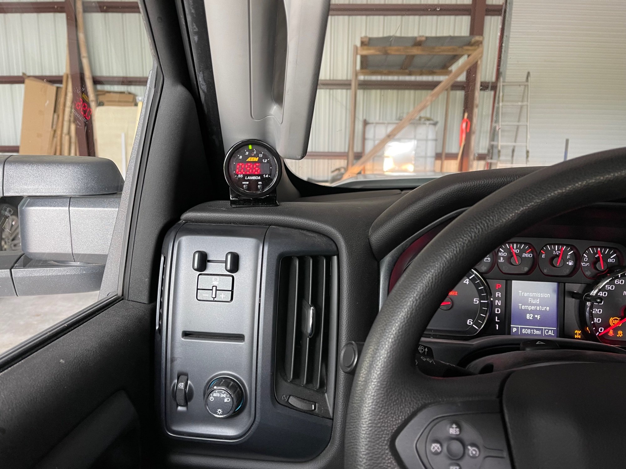

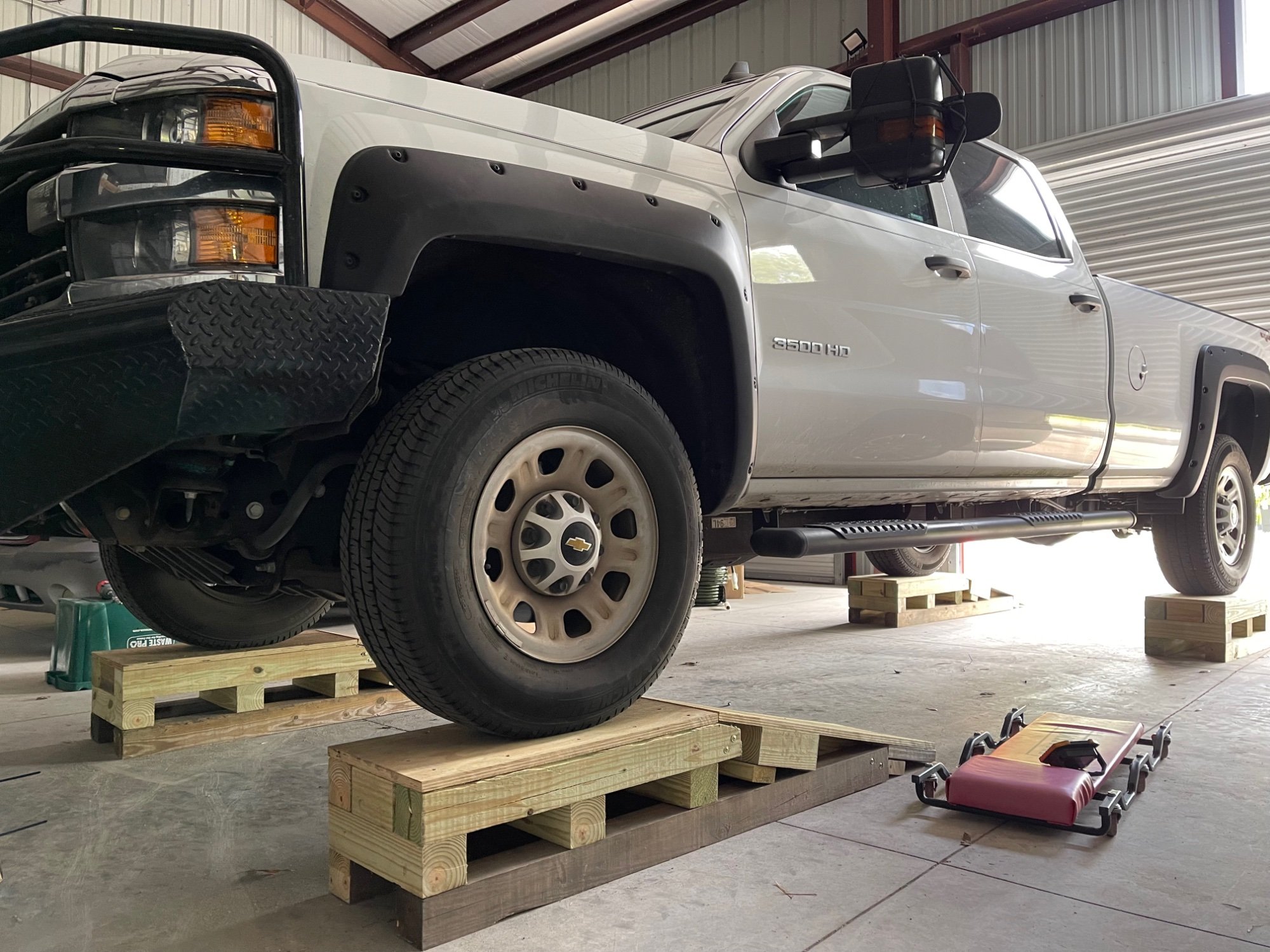

Took off cat section of exhaust today and welded in a bung for my new AEM wide band so I could use it with HPTuners to tune my engine. I built 4 ramps to easily lift my truck up 12 inches a couple months ago and they allowed me all the space I needed to take off the exhaust.  It was easier to weld than I thought it would be. I used .030 flux core wire feed with no gas to weld on an ICT billet mild steel bung. It looks great after a bit of grinding to finish it. Wide band works perfectly and can’t wait to start learning the tuning processes as described in the HPTuners forum!

10-4, it is the new bung on the passenger side in front of the cat. In the picture the 4 old o2 bungs just have tape covering them, the new bung has a plug in it, because I painted it.  Went for a test drive and wide band is working great.
Got my 180 degree thermostat in yesterday. It was such a pain to burb the cooling system. I put the front of the truck on ramps and squeezed the hoses. I had to start the truck, wait for it to warm up, turn it off, squeeze hoses, add fluid, repeat like 6 times. Then test drove it, then added more coolant, then parked it overnight, then added a little more this morning. I know there is some kind of tool for fluid filling that uses a vacuum pump but this is ridiculous. I may have to come up with a fill tap-in to put in the upper radiator hose because I will probably need to do more of this kind of engine work as time goes on.  End result: runs about 10 degrees cooler. Used a Motorad 523-180.
