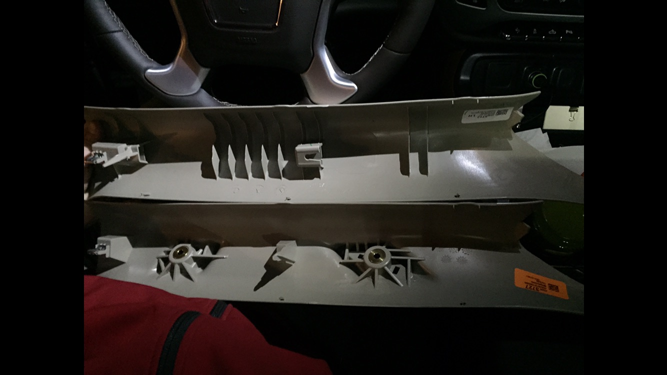

So I ordered the shale handle, but the tab in the center of mine where the air bag clip goes looks completely different. Anyone else have this issue? Ordered part number 23135700, but don't see that number on the handle anywhere so wanted to be sure i was sent the correct part.
  • Replies 480
Mine was the same way, do yourself a favor and just remove that clip while you are in there. I am assuming that you don't need the clips because in the event of an airbag deployment the clip kept the pillar in place so it didn't mess up your teeth. With the handle installed the bolts keep that from happening.
After a thinking on it a few minutes, I decided that the center plastic stud on the new pillar was useless, because with the bolts in place you obviously don't need it for stability or alignment. Didn't feel comfortable removing the airbag clip, so I trimmed the plastic stud down a bit and she fit like a glove. I echo the thoughts of many, so simple why is this not standard equipment?!?!
