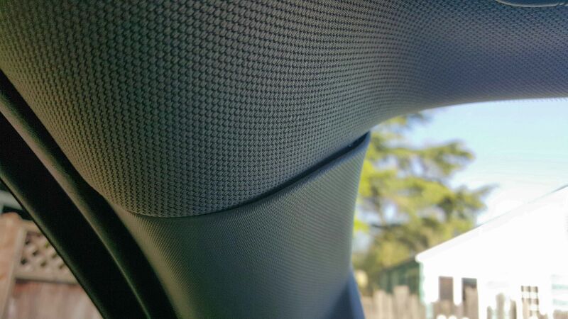

Strange, so mines some weird ½ breed? [attachment=44982[emoji14]ART_1427395273687_IMG_20150326_143827213_HDR.jpg]
Ya that's the Shale, I believe light gray and Shale are the only 2 colors they make the upper interior in. The part # for the Shale is 23285089.
