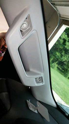

Those of you that have put your driver assist handle in ... you know that black clip you hand to undo to get the old off? What happens with it on the new pillar? Mine doesnt have a slot to put it back in
That normal
That normal

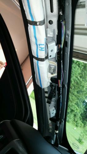

You have to pry it out of the A pillar. I used a thin screwdriver and severe force. Once that tether comes out, it reveals a little hole where the "spike" on the new trim piece will fit into.
You don't actually have to remove the tether. You can fold it back, just separate them, and put the spike in the hole in between the lines. I did it that way, just in case I ever wanted to put the original trim piece back on.
Mine fits perfectly, but you do need to separate the lines in the tether, and go right between them with the spike.

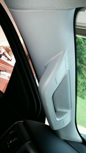

So I get a call today at noon time that my handle has come in at the Dealership and I picked it up within an hour and like other's have said I installed it in less than 10 mins!
The supplied instructions are a waste of paper, so I followed the steps listed in this thread.
I really like the handle, for me it seems easier to enter and egress the cab and again I'm 6'2".
This handle should have been included with the truck, but I'm very happy I found this thread and it was so easy to install too!

Installed mine over the weekend. Caveman easy. Took all of 5 minutes. Got it from ShopChevyParts.com. $49 TYD. I love it. Looks great. No gaps. Love the symmetry. I'm using it all the time. Saves your leather seat from unnecessary wear if you use the handle instead of sliding in and out so much. Great addition.
Finally got around to installing my handle. Like others have mentioned it's a real easy quick upgrade. Old one pulls off easily. You need to disconnect the little black plastic tether from the original by popping the little clip out. I left mine attached to the vehicle and the plastic piece that sticks out of the new handle just went in between it into the line up hole. Snapped the top in and line the bolt holes up and you're all set. No more grabbing the steering wheel.
