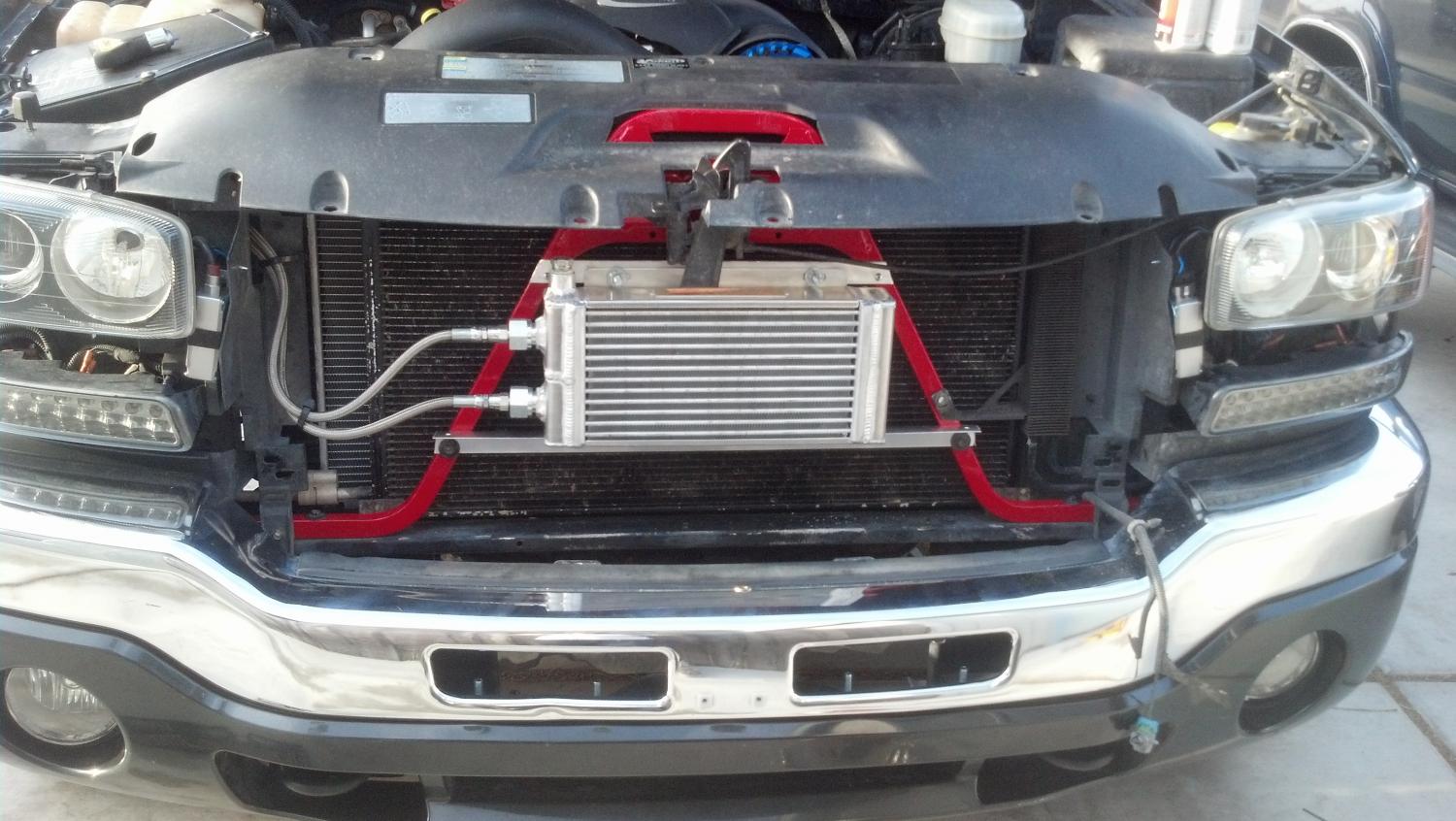

Here is what will help. Install this cooler and replace the lines and problem solved. Fluidyne stacked plate 2 pass cooler and -6 steel-braided Teflon hose
I don't remember, I didn't feel like making the hose so I had the local hydraulic shop build and run the hose, and while they were at ti they put my cooler in place. I think I payed like $450 for all 3 hoses, fittings, and install. That includes the fittings to go from radiator to AN
